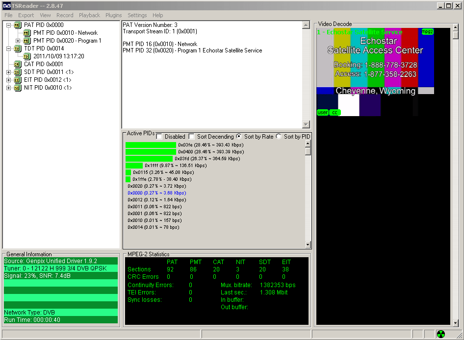

The echostar slate on 105W Ku , is 12124 H 1000 . I can lock it with the Manhattan receiver, but nothing else that I've tried. You might practice on that, too.
I can lock that on the Solomend, but it will only scan and show a picture on Pre-June 2010 firmware.
Strange.
Looking at your signature, I can not understand why you can not lock.
My SkyWalker-1 locks just fine (though, as you can see, signal strength is rather low).
Also, my SkyWalker-1 reports that it's 12122MHz (2MHz off).
Some Tuners (DVB-s card) may need to know exact frequency for such low bandwidth signals, otherwise they may have hard time to find this signal.
Try to lock with different frequencies.

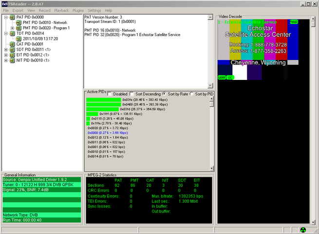

Genpix,
