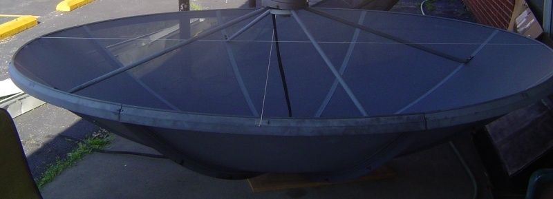

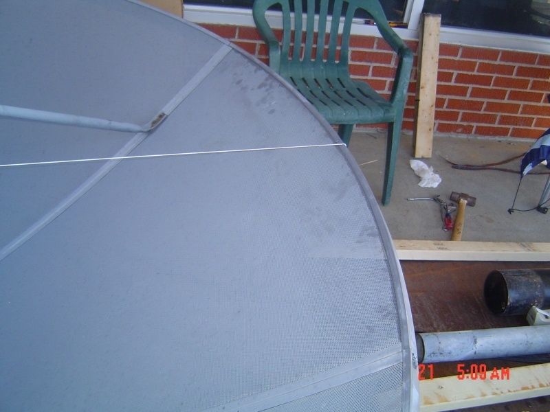

I had to fix the panel that was pushed in by the lawn mower.
I pulled off the piece of the outer rim, and gently tapped it back into shape with a hammer and 2x4. I pushed down on the perfed sheet, and every thing pretty much popped back into position. It isn't perfect, but it is pretty darn close.
I then did the string test at 3,6,9, and 12 position. Then I did the string test at 1:30,4:30,7:30, and 10:30 which included the damaged panel. The string met in the center perfectly in both tests. No warpage at all.
Here are a couple of pics. The one is a little dark, but as you can see versus the others in this thread, the panel is straight again.

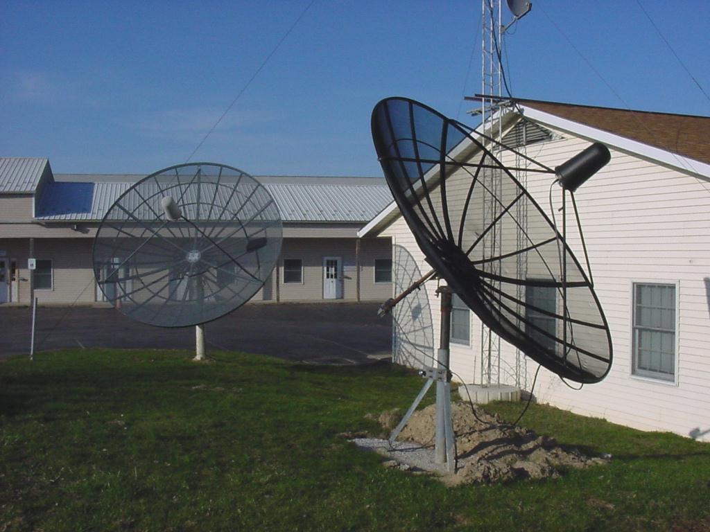

I have been a dish hunter for the past 2 years with the help of my young son. This time of the year is best, the snow is gone, no leaves or bees yet. Last year we spotted the 12' Sami dish in the background laying on the ground partially disassembled. The next week it was up. Last week we noticed someone just installed a 10' dish in front of it. I'm not sure who uses them,they are behind a commercial building that lists a plumbing company next to pizza place. But it's good to see C band still in use.

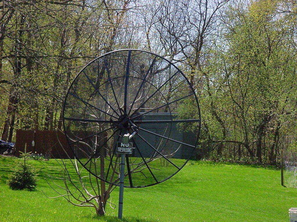

I took this photo the other day. Judging by the sign on the dish, I wonder if the owner is tired of people asking about it. The trees in the background must be a problem.

No doubt the tree just in front of the dish was a problem too! Looks like a northern garden, white spruce in left middle distance, and the tree immediately behind the dish looks like a Norway maple. I would say it was cut down to a stump about 6 years ago and since then has sprouted up from the base. The owner has not cared since at that time they switched to small dish.
Judging by the slant on the pole I'd say it was fair game for a removal. Just tell them you will leave the pole for them to hang the sign on!
