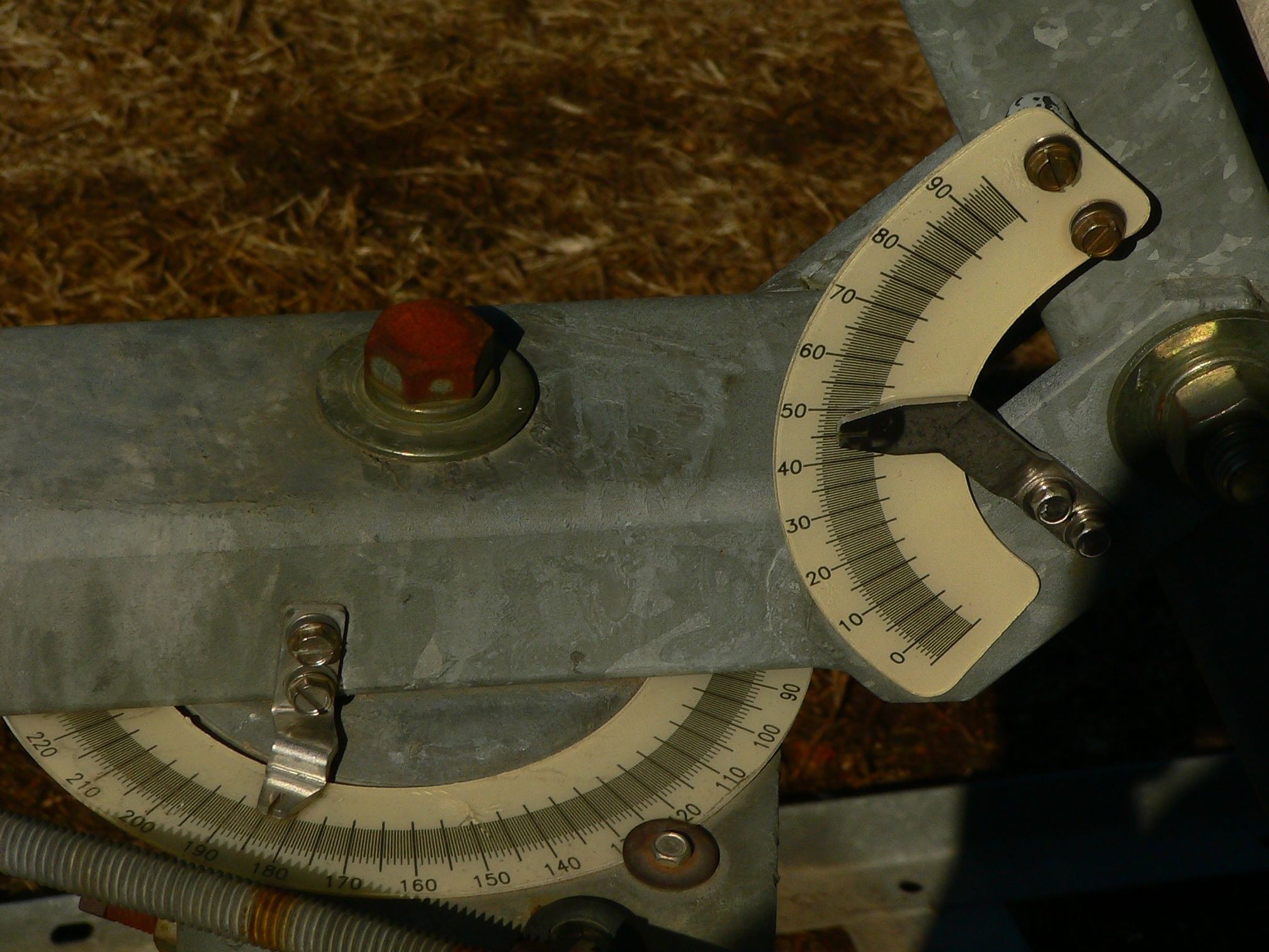

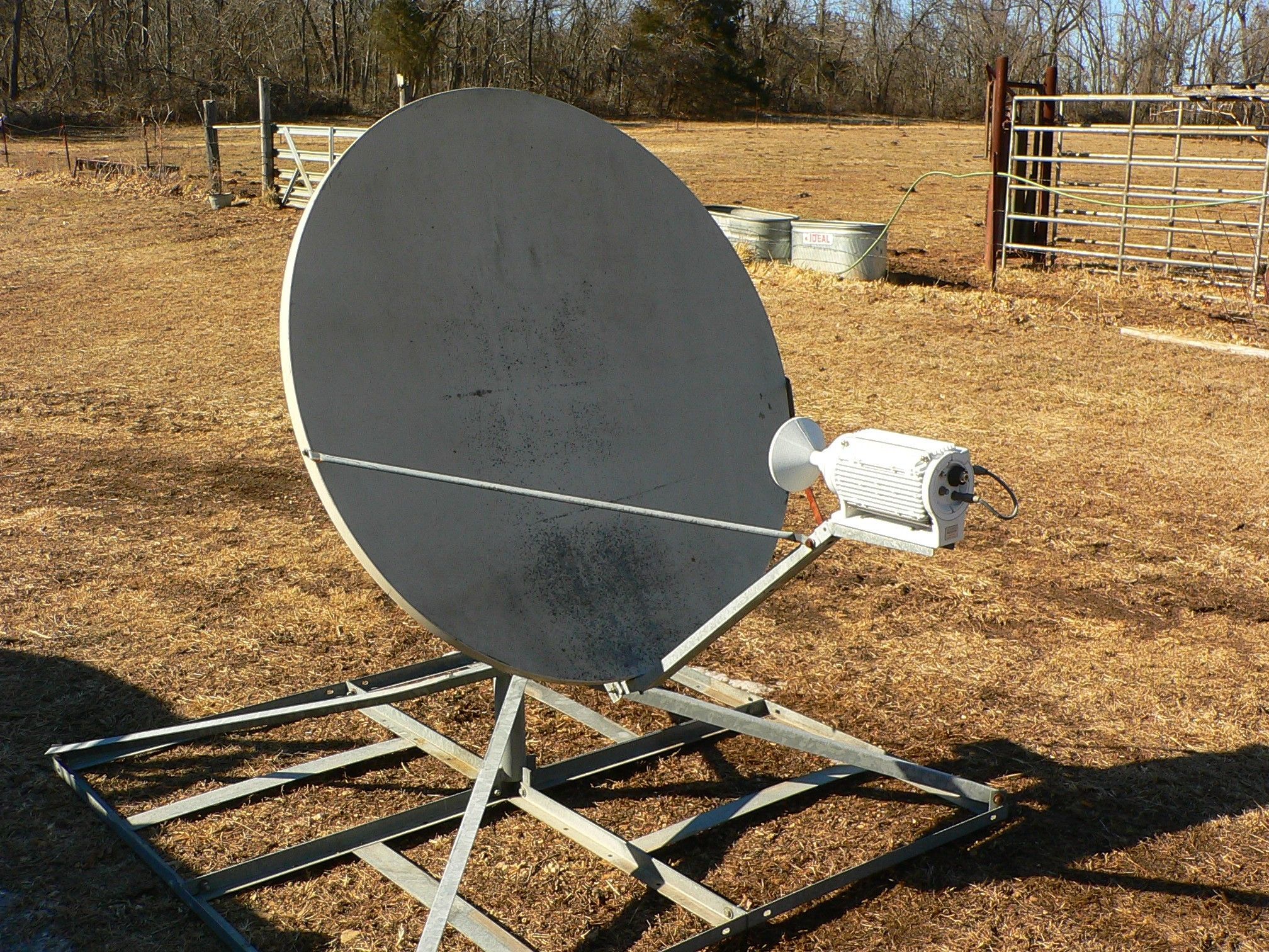

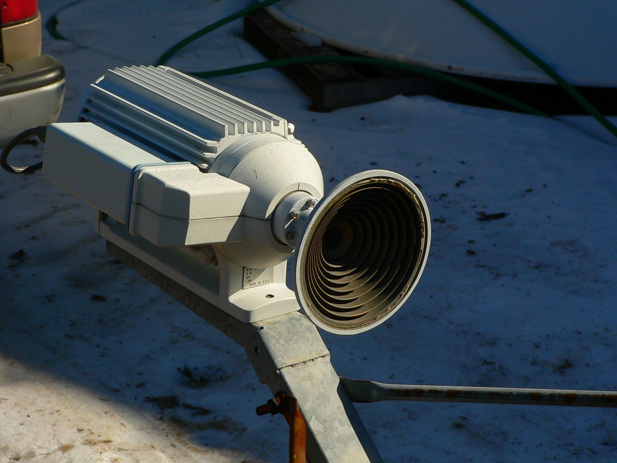

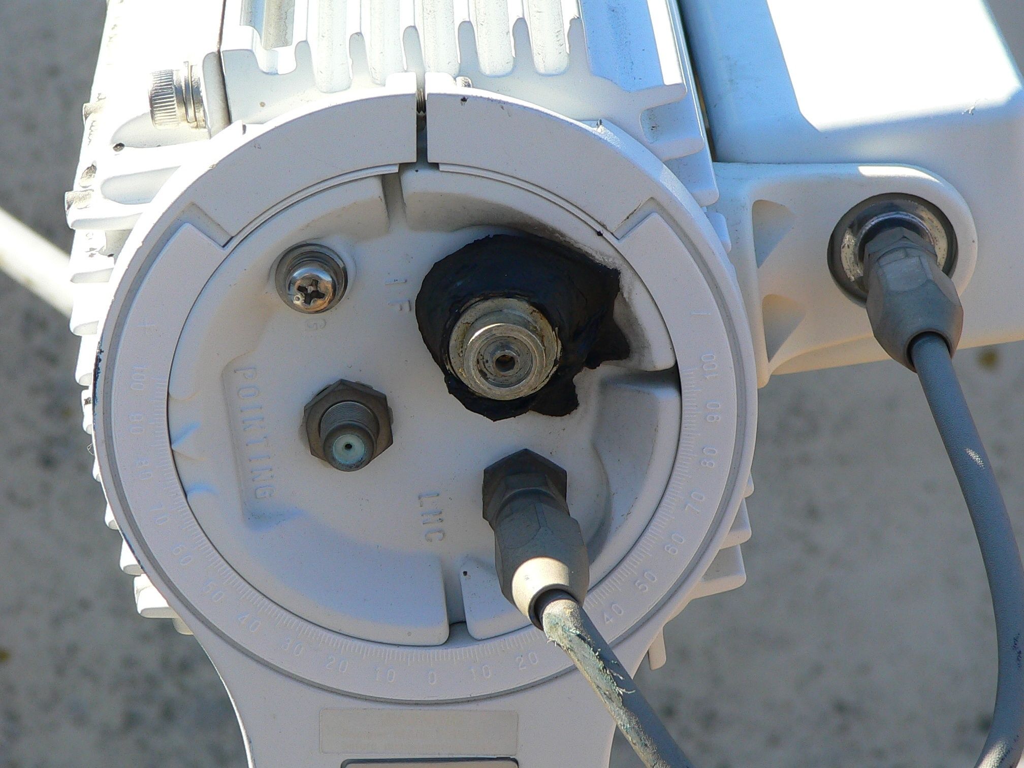

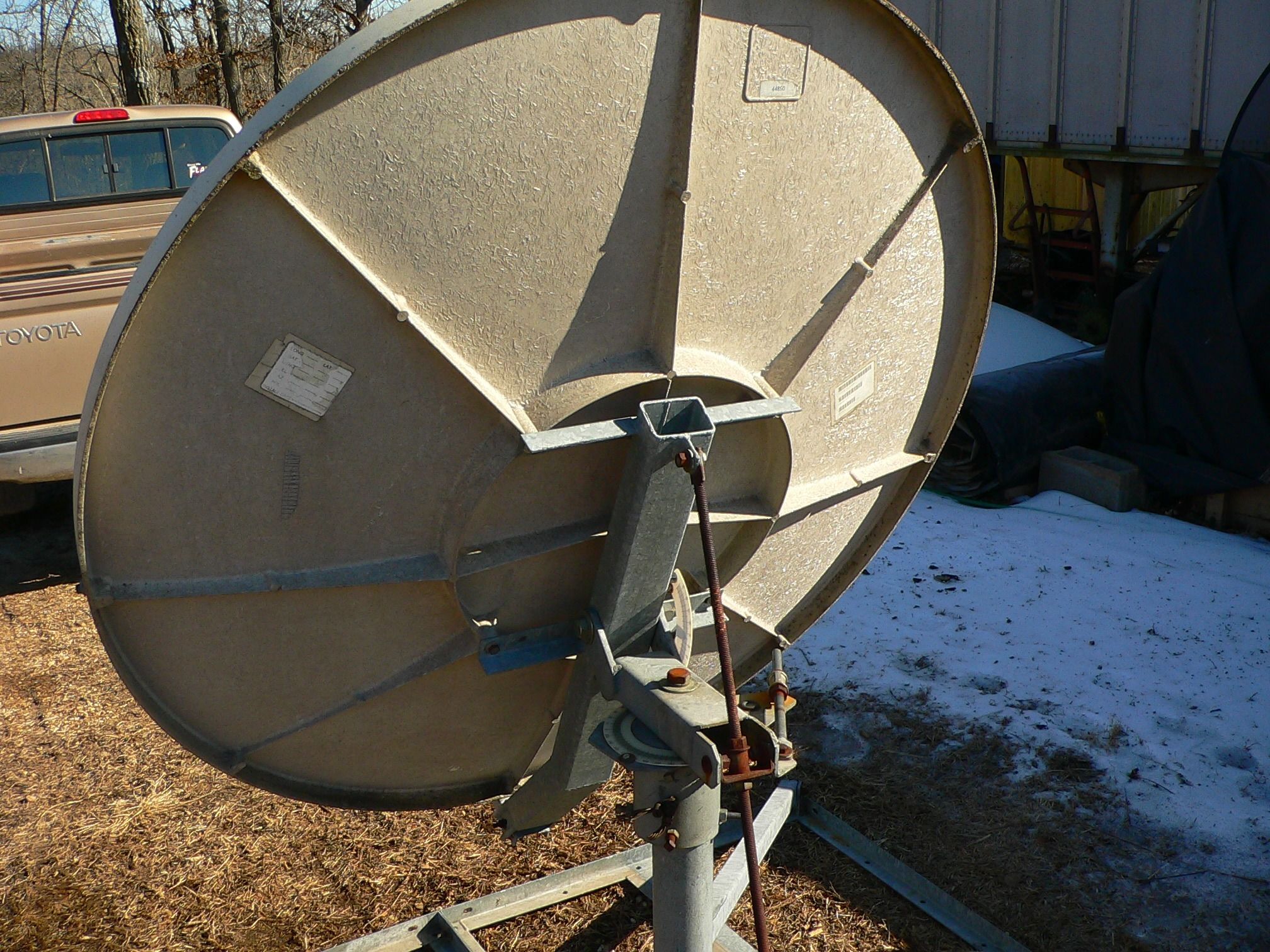

Anybody know what make this one is, have any specs/info?
It's 52" tall by 48" wide, came with that nice non-pen mount....wish I had a big flat roof or parking lot to set it up on. ;)

Looks like a bidirectional Ku setup. A data dish. Bet it weighs a ton. That should be a nice Norsat Ku lnb on the side. Should be no trouble to replace with the lnb of your choice. It will be awesome for a Ku fixed setup!
Nice Find!
Just by looking at the mount and way the back is molded, I'd say it is a 1.2 M Prodelin. :)

I think you are right about it being a Prodelin, I've found some pics on the net that look very similar, but not sure what model mine is yet.
Does Prodelin have a "standard" offset angle for their 1.2 's? :confused:

Thanks, Cads! I haven't looked at the feed much but am guessing that the LNB is a single-polarity linear of some sort? I am considering attaching this dish to polar mount and moving it with a linear actuator/G-Box combo.

congrats on the 1.2m Prodelin
Gremlin and DreamFox's Prodelin 1.2's look like yours.
Similar mount.
LoneWolf and ACradio have a different mount on their 1.2 Prodelin dishes.
For motorizing ideas, search out LoneWolf's efforts. - :up
phlatwound the offset angle for that dish is 22.6 degrees. I set up 79w on mine the other day to see if I could. I t has fixed mount on it, I found the angle and subtracted 22.6 from it and it gave me like 28.4 are something like that When I was done locking 79w I was at 28 even.
That one would be interesting to mate to a polar mount, with the way that bar across the back is connected to the lnb-support. If you could find a similar polar mt with the right kind of lower attachment, maybe it would bolt right in. But that prob wouldn't account for the extra 22degrees or so that you'll need to factor in. Now if you could bolt it to a piece of flat steel plate, like I had to do my 1m primestar, you could fashion something for the extra offset angle.

fantastic idea:

I can see the existing elevation screw being used to dial in the down-tilt to compensate for the 22° offset.
And in the greater scheme of things, I believe that'd be called the declination.

Am I correct in thinking that I need to add my declination value to the offset angle when I build an adapter?

Anole, good idea about the existing elevation bolt-but when I built mine, I found that wouldn't work accurately in tracking. Later I was TOLD that I couldn't get the extra 22 degrees that way either, that the polar mount itself needs to have the site's declination and elevation only. The extra angle has to be taken out elsewhere, in my case I used that azimuth/mounting plate off the DirecTV KA /KU dish I was given. It luckily had enough tilt in its base, that is where I got most of the extra 22 degrees.
I did try it MY way first, lol of course, but found the ku would only track about the middle half of the arc, no matter how I adjusted the polar mount's elevation or azimuth. Of course, that HH mount would be infinitely easier.
