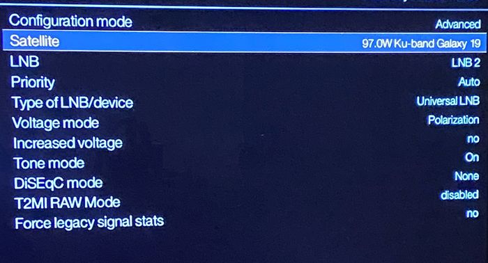

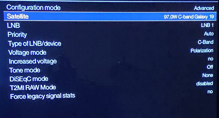

One more thing...can you check that my settings are correct in the enclosed pictures.
C band LNBF is attached to line 1 of the 22KHz switch and the Ku LNBF is attached to line 2.
Thanks in advance for all your help.:hail
John
The KU LNB type might present a problem when using with a 22KHz switch. Is the KU LNBF a universal type with LO 9750/10600 or a standard type with LO 10750?
A Universal type LNBF on the 22KHz side of a switch should create the signal path to both the correct switch port and the the correct high band LO 10600 to receive 11.7 - 12.75GHz range, but this set-up will likely duplicate scan all KU transponders (correct frequency and an incorrect frequency) and also duplicate the logged services.

Hi Brian,
Looking again at my Ku set up I now notice that it should be set up as a standard not universal LNBF.
Thanks for pointing that out.

Yes, you are correct about defeating the switch point by changing the STB to a single LO type. John had the LNB type set to Universal and the 22KHz ON. That configuration would likely had resulted in a double scan.
I wanted to confirm the type of LNBF before providing the correct set-up instructions for the installed hardware. :cool:

Brian,
One more bit of clarification please.
You wrote, "Set the band setting to either Band = ON if C-band LNBF is connected to 22KHz ON port or Band = OFF if the C-band LNBF is connected to the 22KHz OFF port. "
By band setting do you mean tone mode and by "on" do you mean the "on" mode or the "band" setting mode ?

E2 images use different terms. Yes, for 22KHz port to be active, select Tone = ON.
Don't use the Tone = Band, as this is used for Universal type dual band / dual LO LNBFs.

Did you mention if you have, in fact, a universal Ku-LNB; as opposed to a standard LNB?
When you have a universal LNB, and when you want to use the high band part (LOF 10600) of it, that LNB should be on the 22kHz ON side of the switch; and so the C-band LNB on the OFF-side of the switch.
In a universal LNB, the 22kHz is needed for the high band.
For a standard Ku-LNB, however, you can use the ports as you like, as the 22kHz has no function in a standard LNB itself.

a33,
Good to hear from you.
I don't believe I made it clear to Brian that I had a standard Ku LNBF (Maverick MK1PLL), my mistake.
I did however, connect it to the powered port none the less. It still needs some tweaking a bit at the dish, to get a good steady signal.
John
