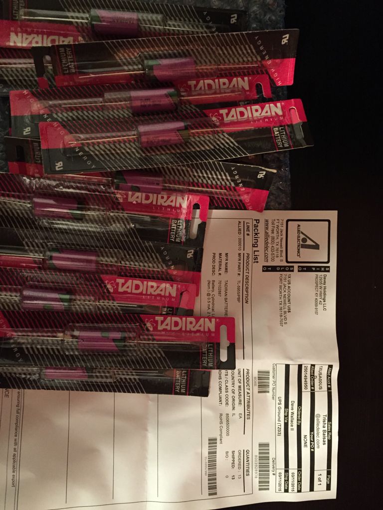

It's easy I've changed hundreds of them.
I just got some bats the other day they are getting hard to find.
Try it yourself :) the cost of shipping to and from will buy you the usb jtag.
I have changed batteries in DSR920 and Dsr4200 but not DSR922. The trick is to bridge old battery with new and then remove old. If the battery is dead then the receiver can only be restored to partial condition and map master is used to get maps back and will work on music channels and as a dish mover. I restored one receiver this way.
I've done it for others (from another forum) before.If you're interested send me a "conversation" and we can discuss it further.You would have to ship it across the country,I'm in New York.
