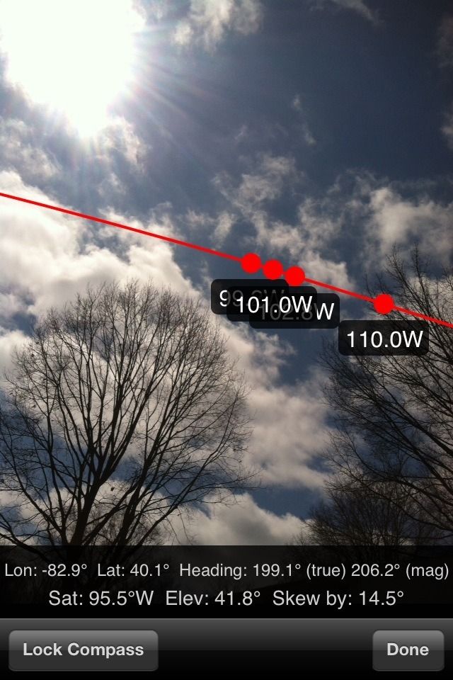

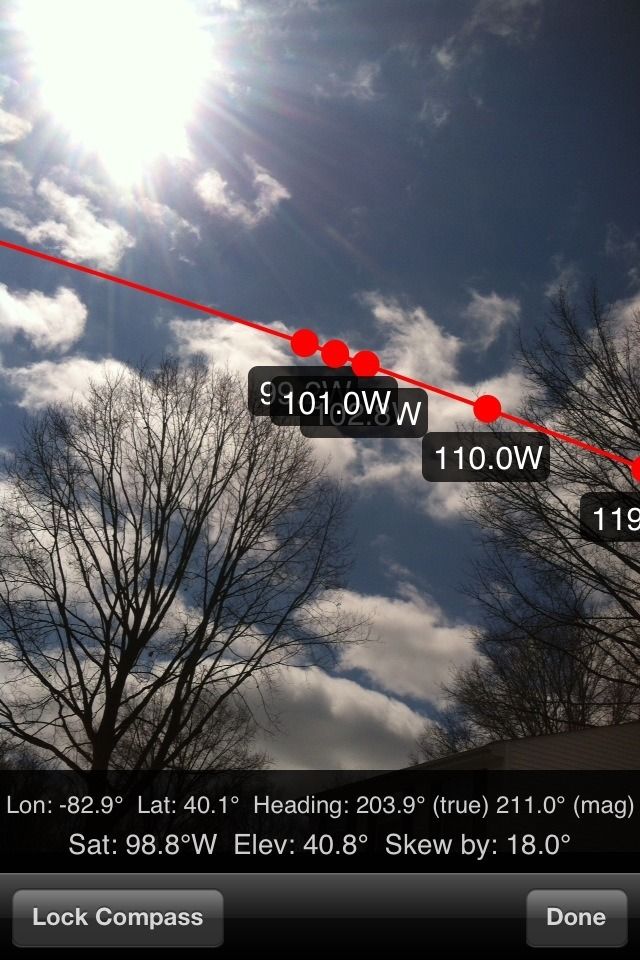

Well, after almost a year of terrible service from TWC/Insight, my wife has reconsidered the possibility of having a satellite dish on our front lawn. I'm still not positive that we can't get a signal from the roof, but if a front lawn install is necessary, the wife is willing. I'll be setting things up in April. If I wanted to do an install myself due to directv installers wanting more of an open gap in the trees, how would I go about it?
I would start using a smartphone app to find the best spot for the most open line of sight.
It looks like these two spots will be my best bet. Both are on my front lawn. Now it depends on how strict Directv will be with me.
Since your local sd channels are on 101, the second location may be acceptable.
