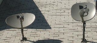

More detailed answer: In order to get the 95W signal, you will need a different dish more commonly referred to as DirecTV World Direct Dish (the dish on the left in the attached photo - notice the odd looking LNB). This dish receives signal from both 95 and 101 only!
If you need to receive signal from anywhere else (99, 103, 110, 119), you will need an additional dish such as a Phase 3 or AT-9 (dish on the right in photo) or AU-9 Slimline.
A 4x4 will work with the World Direct Dish if that is all you want but again if you want to receive signal from any other location you are going to need to change out your MS to something which has a Flex Port.
Hope this helps!
