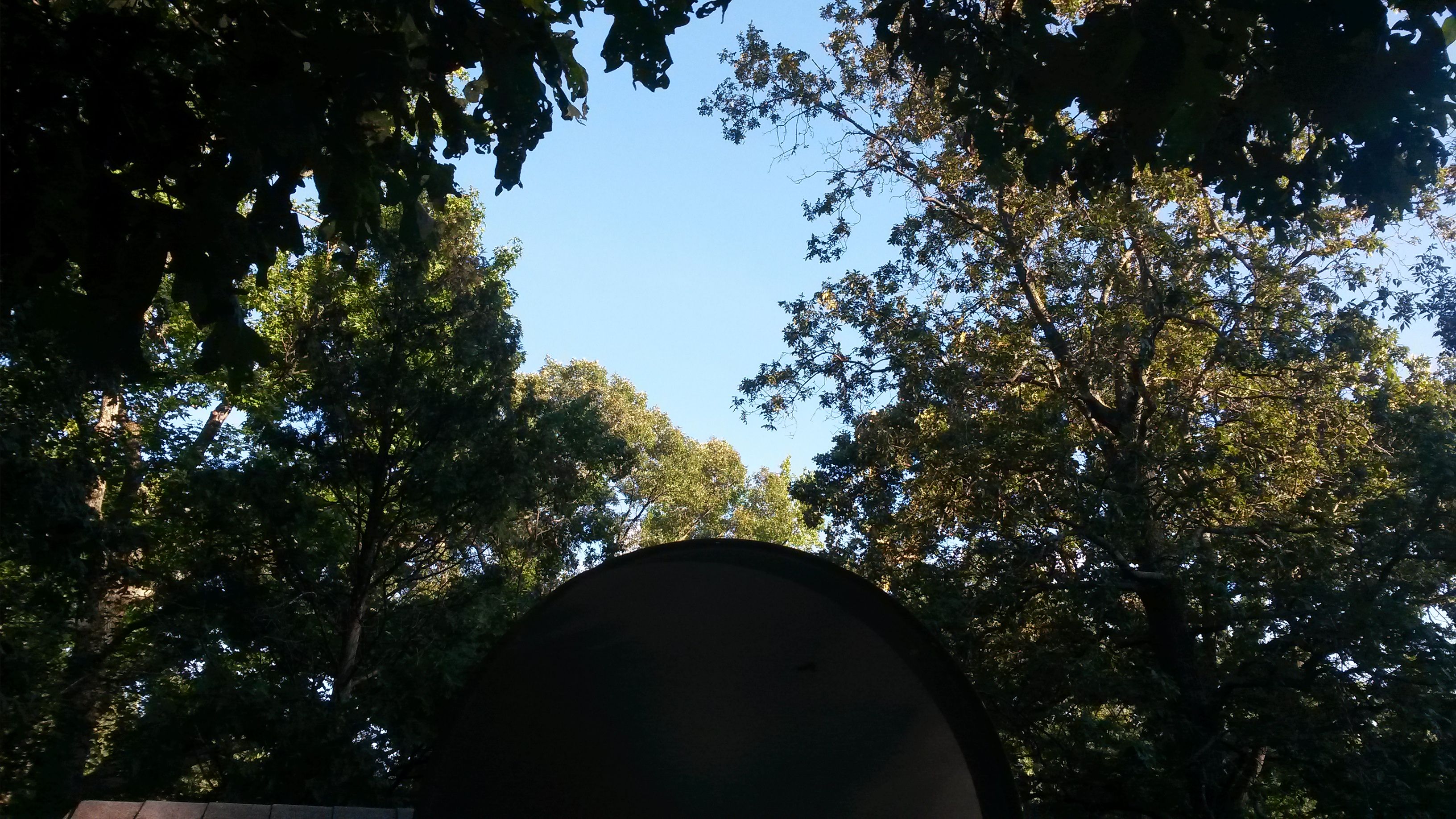

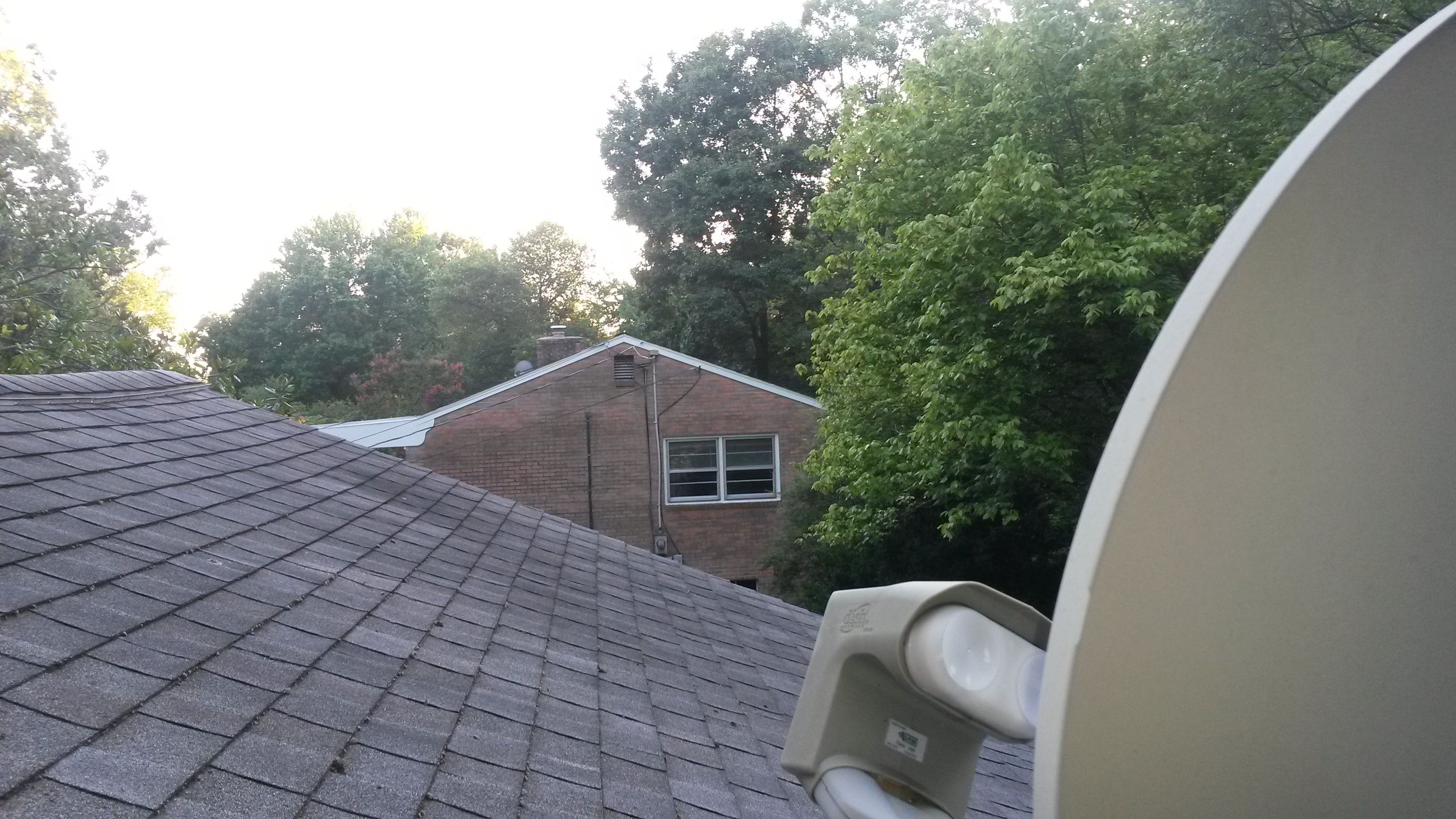

Here is my window for 61 and 72. Never have captured 72, except in the winter w/o leaves from the huge hickory to the right.
Image rotated for some reason.
l
download
Still trying to post photos. EEK.
Yeah. Posted a photo.
Bad news is it is not related to satellites.
Now, can I reproduce results with pertinent images? ? ?
This is my window to the eastern arc. Photo taken behind a dish 500 pointed at 61.5.
As you can see the available window for birds is limited.
I can grab 61.5, but 72, to the right, is blocked in the summer with the leaves.
72 works in the winter with leaves down, but that sucks come summer, IFYKWIM.
Need to drop a 70 - 80 foot Hickory tree, which is the beast to the right. This tree is beautiful, but makes an incredible mess.
The nuts drop and dents cars below at the driveway.
Darkest material in photo is limbs and trees closest to dish. IOW above it. Which I finally realized can also interfere with the signal. Because the birds are higher than you think.
In my town that is $1500 -2000 for a licensed, competent, insured tree service provider to drop the tree.
Who won't drop the tree on the home. This trunk is 12 - 17 feet from the home.
Power, cable, copper phone, fios, all in the tree. Literally. Oh my.
Base tree trunk diameter at around three feet. This tree is a mammoth. And growing like a weed for some reason the past few years.

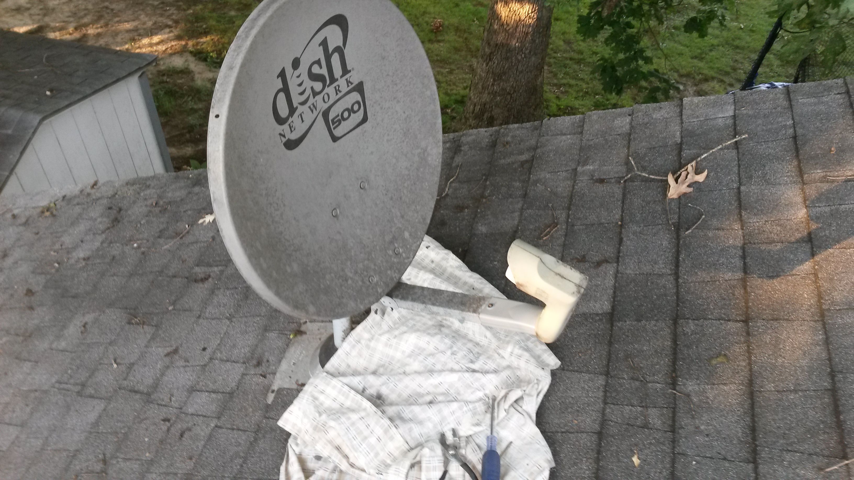

Another pic from the 61.5 reflector point of view. Orange blob is the lnb.
Pic taken from the sat signal pov.
This shows the original double lnb plastic mount that I felt hampered my ability to realize what was in the way of the signal.
I wasn't sure where the bird was, nor where the dish was pointed.
With the single lnb I Bracket installed it was much more obvious to me which trees were affecting the signal, if at all, etc.
Prior, I had a dual bracket for the lnb. Which made me question the true direction of said 61.5 bird.
So I installed a straight, single I bracket, and now I can obviously see laterally where 61.5 is.

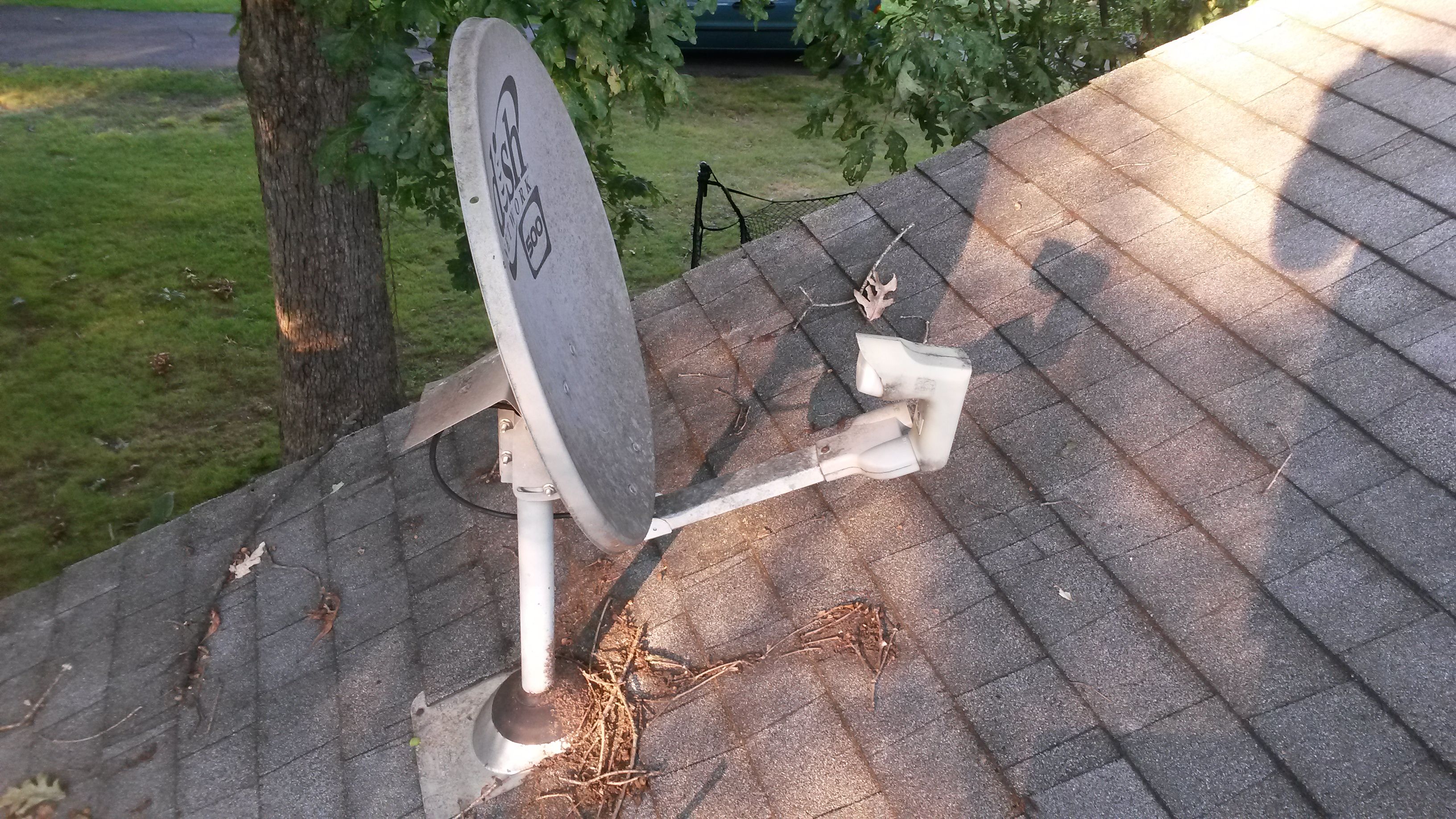

This also shows off my custom install mentioned last year. :oldsmile2
I don't like wires hanging off the side of my home. Nor running on my roof.
So, ... I got some 1.25" galvanized pipe and came up with this.
The vertical pole goes all the way to the ceiling rafters, which in my house are 2 X 6's.
But it's only about 4 feet max down to those ceiling joist/rafters at that point in the roof slope.
And at that point there is a tee, then two foot pipe extensions are added for stability, and strapped to said joists.
Just below the roof penetration is a tee or Y joint that allows the coax to pass to it's destination within the attic.
Point is, this is very stable. The hard part of the install was to get the vertical pipe perfectly level.
I learned here that was very important. Thanks for that tip. Makes everything after that, easy. ie; align dish.

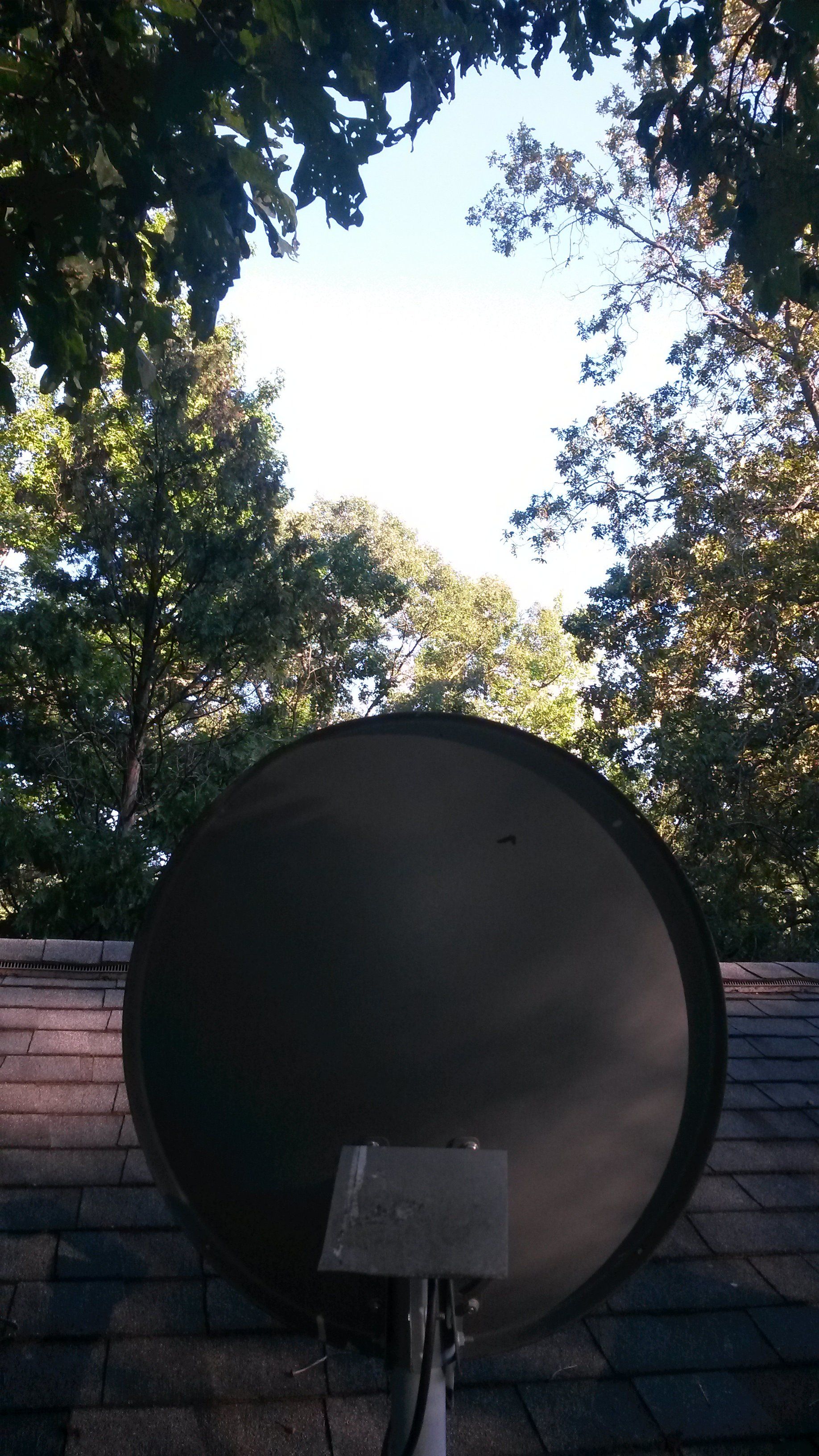

Another pic from behind 61.5 . A tight hole regardless.
72 is just into that branch and tree line to the right.
Like I said, in the winter it may work. Actually that was a few years ago.
I'm sure the tree is totally in the way now.

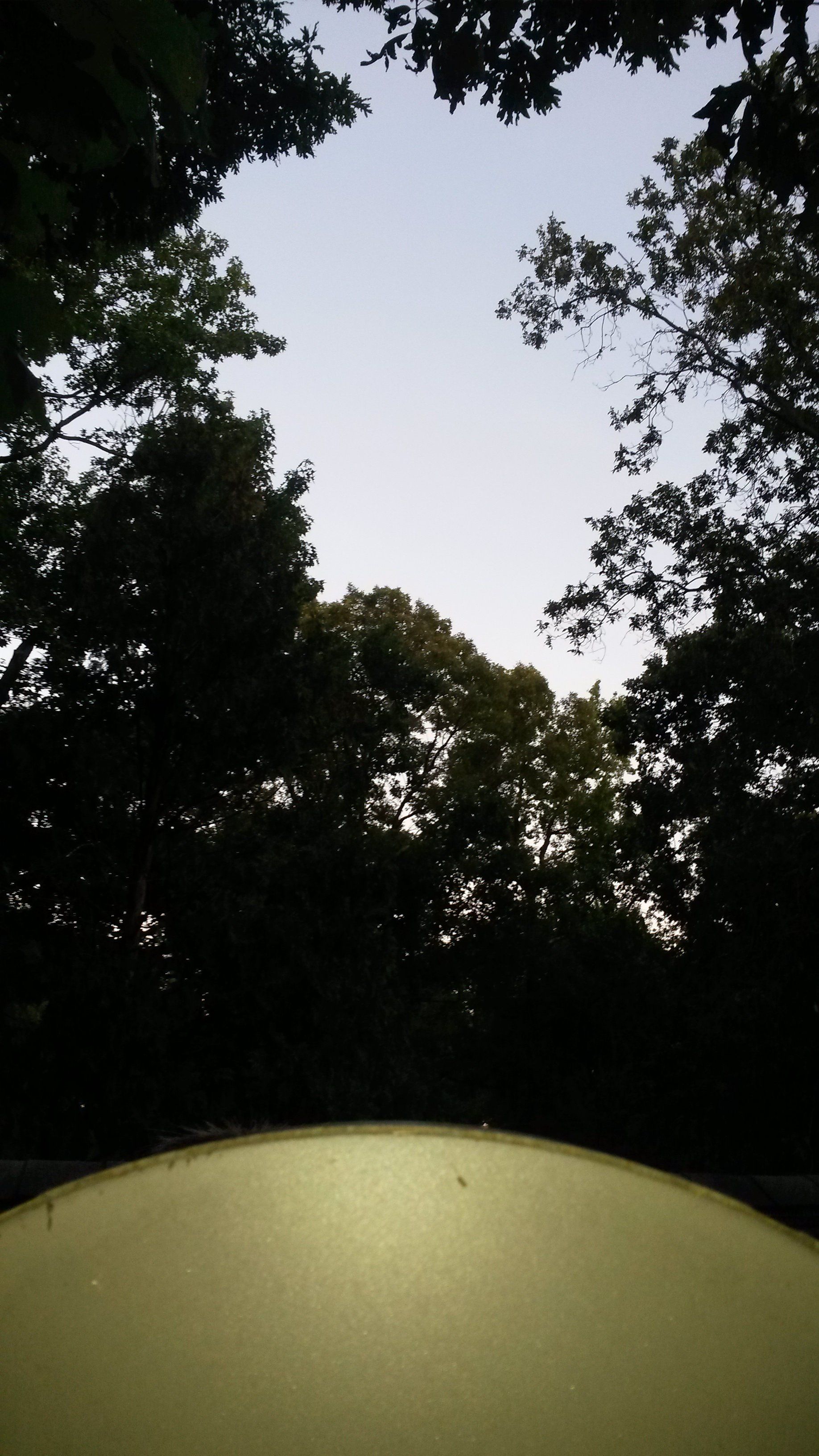

Does the disgusting mildew build up on the reflector affect the signal reception?
61.5 dish after I bracket install, showing lots of mildew. Like, a lot.
At the bottom, almost 1/8 inch thick.
Perhaps it's not just a pointing / tree issue. Could it be a build up of mildew / moss?
Of course an 1/8 inch of moss could affect the signal. Especially if located at the bottom of the reflector.
I know that from being a lurker here for years. lol.
It's like ice and snow affecting the signal.
Do others clean their dish reflector surface? ? ?
Why is there so much moss/mildew?
Refer to previous images.
This dish is in a shade forest. lol. With a small window in the canopy to capture 61.
