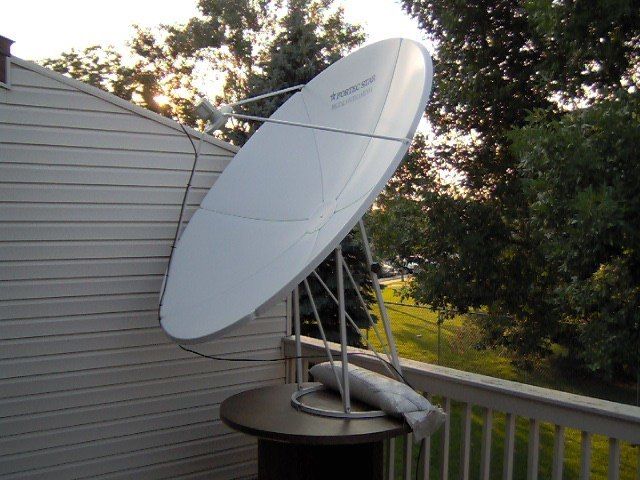

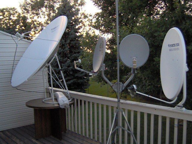

The thing to realize on a C-Band dish is its prime focus
so 45 degree elevation is truly 45 degrees
KU dishes are offset and have between 22-27 degree offset. So they are much lower than they really are. The signal bounces above the dish to the LNB. On a C-Band dish, it comes straight at the dish and bounces to the LNB
here is what I mean
see the below pic. The C-Band dish and the Fortec dish
C-Band dish is at G4/G16 which is 38 degrees and is a prime focus. See how high it is
The KU dish is at G10 which is 30 elevation...dish looks straight :)

sandbag is because the dish is top heavy. 38 elevation is pretty low for a true south here in Minnesota
Have you ever thought of a polar mount for your 6 footer? It would be fun to just swing it east to west with a v-box or analog receiver. Save you a lot of work aiming when changing sats.
nah. The reason its on a table is because of line of site. I can see from 87-107 and most of the elevation is the same. A polar mount is an option but a different house is first where I can bury the dish :)
