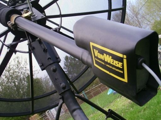

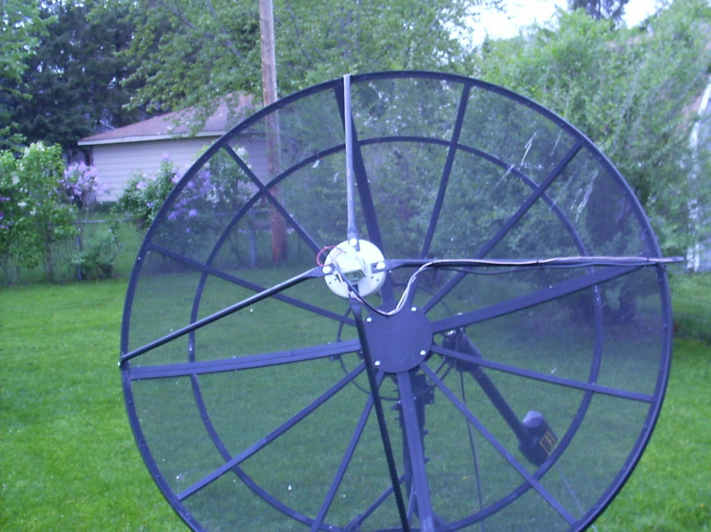

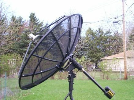

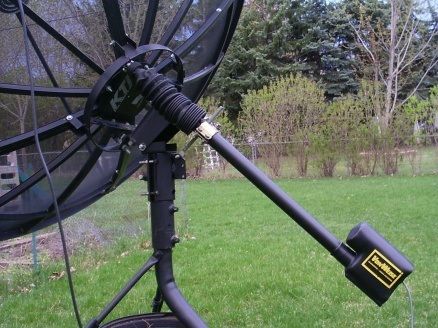

WoW! Yes I LOVE my 6" mesh dish and my VonWeise actuator !
It was FREE, just had to go and remove it!
I had a LOT of fun with my 40" P* dish and if I had not started with it I am sure I would never have got round to getting a BUD!

Hi Pete,
I'm thinking to look around my area to see if I can get one for free. The work to take it apart and re assemble it is easy.
I have a few questions for you:
1. How do you know what size actuator to use?
2. Does the actuator size (18", 24") give you the range that you can scan the sat belt or is that more for the size of the sat?
3. How good is the 6' dish for reception? For example, can you get RTPi on Intelsat 805 (55W) and DW on PAS9 (58W)?
4. Is there a brand C-band dish that you would recommend or have heard things about?
It will be easier to talk my wife into a 6' than an 8' -10'.
Thank you,
Virgil
1. I use a 24" but its overkill for this size of dish
2. As above the actuator I use is too big for the swing of the dish. I think an 18" actuator would be more than enough for a 6' dish.
http://www.geo-orbit.org/sizepgs/tuningp4.html#anchor800428
3. Don't think I can get round that far as my BUD is on the ground and I have some trees in that direction. DW is available else where, thats what this dish was used for before I got it, and you should be able to get RTPi but I would wait and ask someone who can actually see that satellite.
http://www.intelsat.com/apps/coverage-maps/sat_foot.htm?name=805&loc=304.5&beam=0&dir=E
4. I use the Sami 6' mesh dish
http://www.samidish.com/SAMIINST2.pdf
