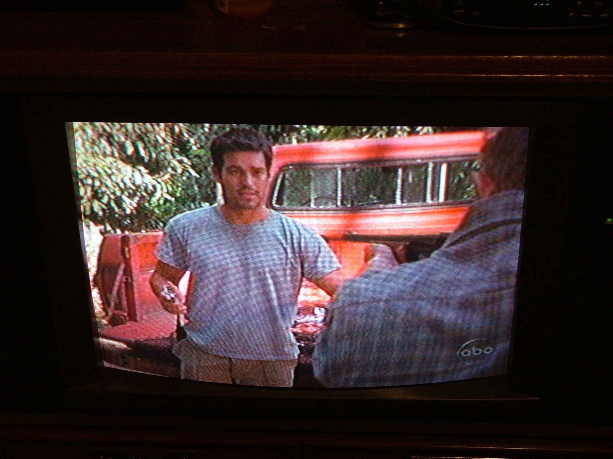

Hey PSB or anyone else who have tried...How is the analog reception on the mini-BUD, particularly those who have tried it on a primestar?
I do not have a PrimeStar, but here is ABC on IA5 from Northwest NC. I am using a Patriot 1.2 and Cband Lnb. The EIRP from my location is 38 and this analog channel is definitely watchable.
What is the best way to do a screen shot like you posted ?
Thanks ,
Wyr
easiest way I do them is take a picture of the TV :)
please use the attachment option when you post them...makes the dial up people happy :)
I will try that , maybe have to figure out how to turn off the flash ?
Wyr
