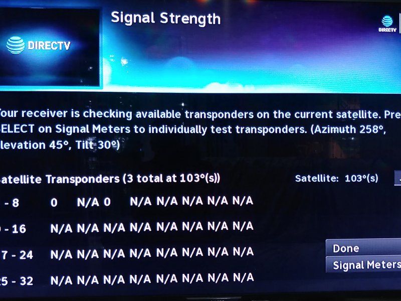

101 signal strength

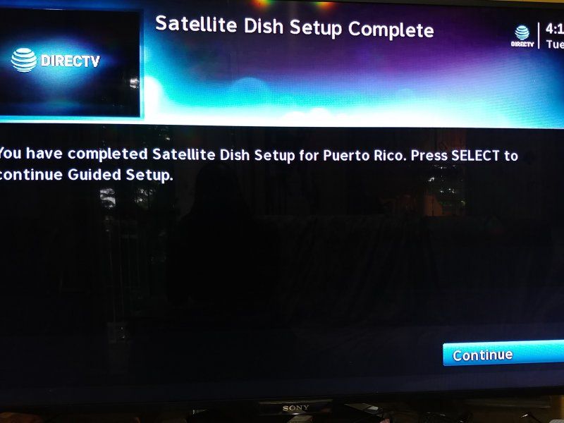

And this confirm PR setup

Quickly, does the 119W signal level screen even show up there in PR?
I always assumed DIRECTV disabled it there since there was no need for it as the 119W satellite (T7S) can't reach PR while covering the US.
Now that's interesting that it shows "you have completed satellite setup for Puerto Rico". In the US, it just shows "you have completed satellite setup". What choices does it give for the dish configuration? I'd assume it doesn't give you the option of "SL3", for instance, but would have to require SL5 since Puerto Rico needs to see the 110 satellite.

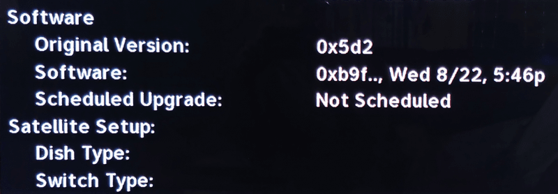

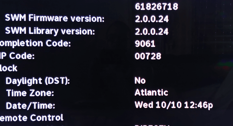

One other request for posting a picture, if you don't mind us constantly bothering you. Can you go the info screen where it shows the receiver model and firmware version, and post that here? One thing we've been wondering is whether receivers in Puerto Rico are running different firmware builds from what we run here in the US, or the differences like the above are accounted for by the access card (the receiver will "know" it was activated for an account in Puerto Rico) or by the info it downloads at startup (currently receivers in Puerto Rico download that info from 110, but soon they will be downloading it from 101 and 110 will go away)
Receiver H25/100 using SL5 Lnbf
Thanks, looks like a normal firmware version for the H25 so probably identical firmware to the US. My guess is that the card being activated in Puerto Rico causes it to do a few things differently, like looking for the 110 satellite at startup instead of 101 like in CONUS, and that "completed satellite setup for Puerto Rico" message.
