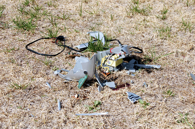

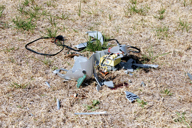

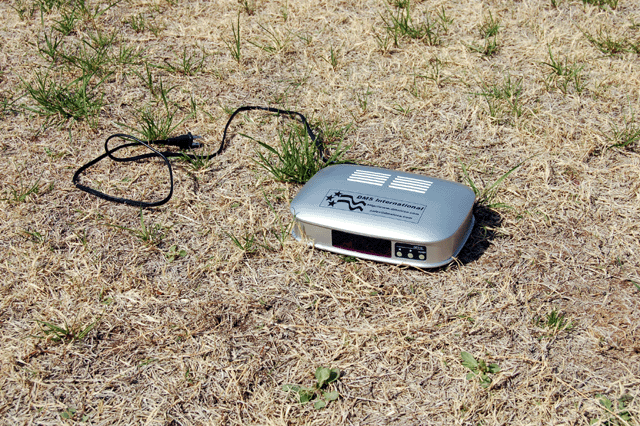

I got revenge on my VBOX I :
that is -awesome-
Ok. So I do feel a little better from your pictures. Very cathartic. I see the same guy does your lawn too. ;)
