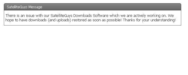

Press and holt your control key and then hot refresh on that page as it sounds like you have the old closed page stuck in cache.
There is an issue with our SatelliteGuys Downloads Software which we are actively working on. We hope to have downloads (and uploads) restored as soon as possible! Thanks for your understanding!
