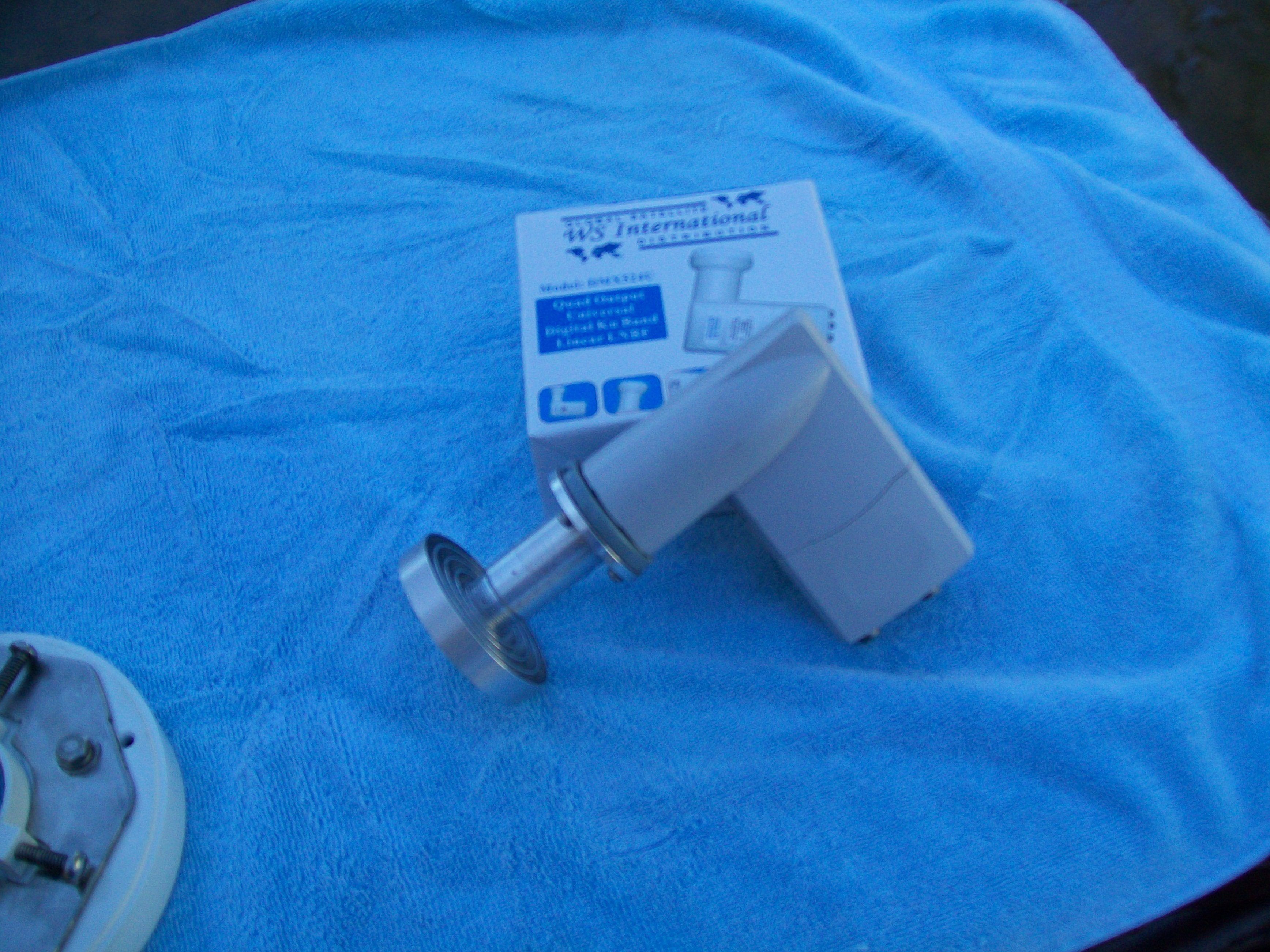

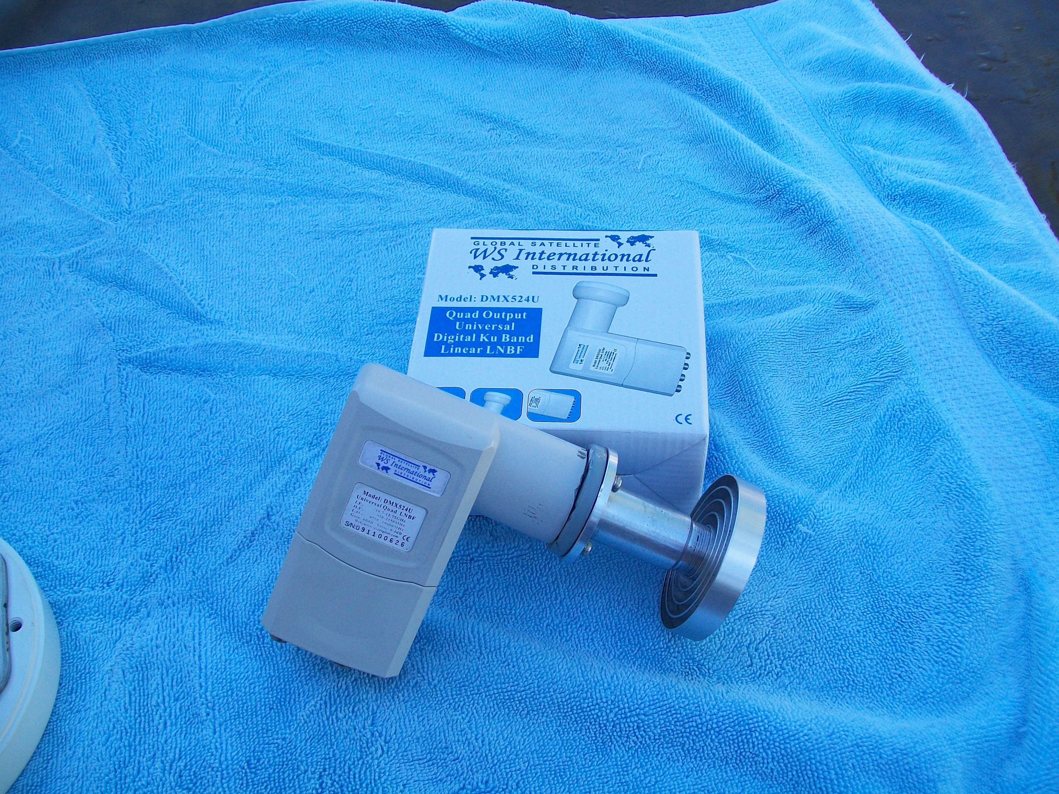

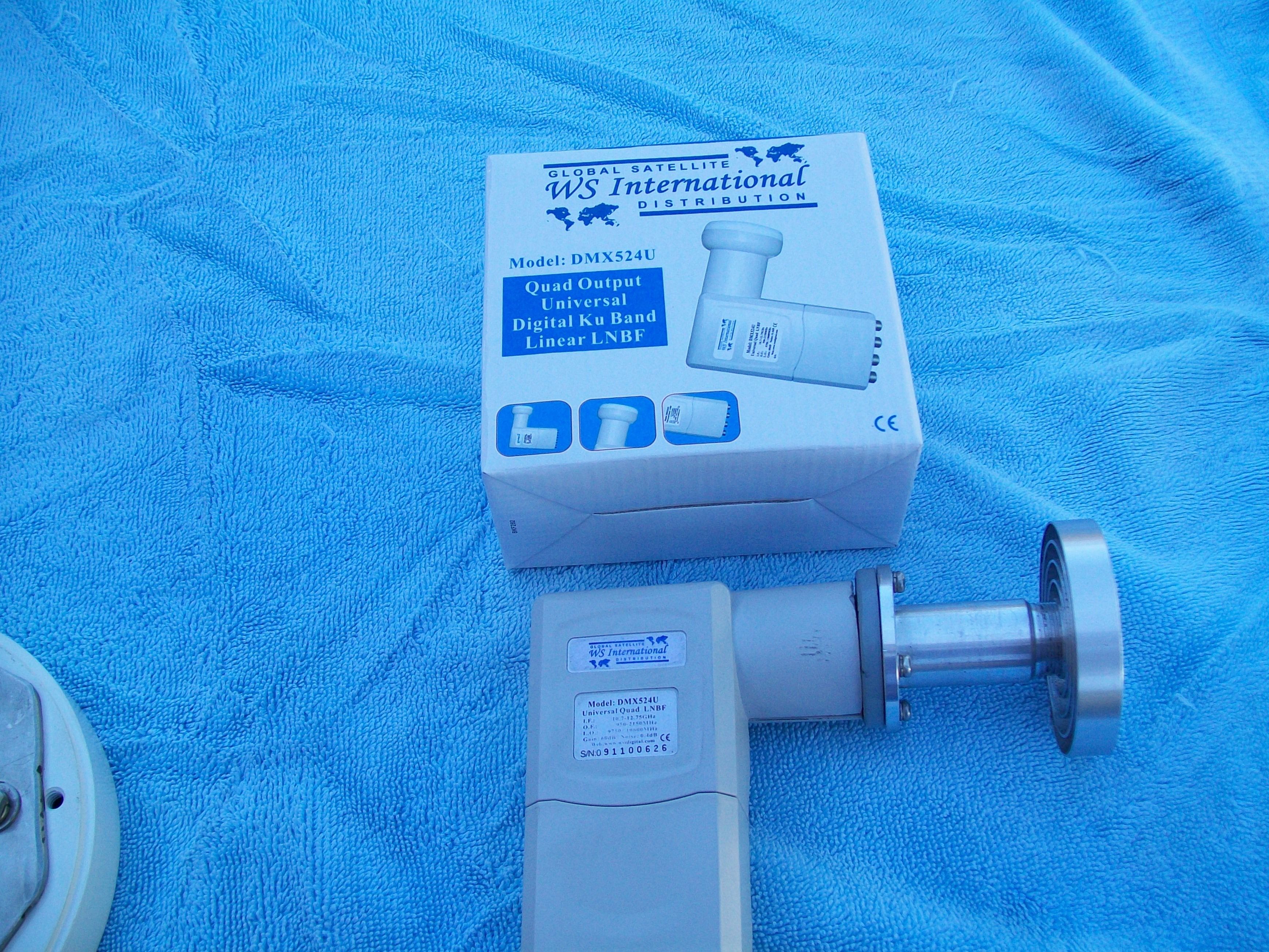

Robby, I got 2 of these 4-out put universal lnb-f's, and I am very happy with the way they perform.
but my ? is to you, why don't you make any of these universal lnb-f's like this??

Nice mod! :)
Was actually thinking of doing a dual output universal or standard for a prime focus dish, but I'm not sure how popular that may be.
Looking at it from a business or marketing stand point, it may be better to make them with a c-120 flange. then this way the customer could either use it on a offset or prime focus dish, and sell the Invacom ADF-120 also. 1 lnb is on a 10-ft dish with a Invacom ADF-120 prime focus feed and scalar, the other WSI lnb is on a 1.8 C.M. offset Ku dish bolted to a Channel Master feed horn for that dish, now my signal levels and my CNR is a lot better than when I had the WSI lnb on the 1.8m dish the way it came out of the box.
another thing that I found out Robby, when I was doing the tuning on the prime focus dish, is the setting of the scalar ring F/D ratio was so very inportant to get the CNR down, a small adjustments made big changes in the CNR. so if you did market them for a prime focus dish, you realy need to have a adjustable scalar on the lnb.
hope this small amount of info helps their Robby.

Robby, my honest opinion. Captain1, should have a place in your R&D department!! Can you imagine how much more he could offer if he had the right equipment from your R&D department? :)

:up Excellent!

of course this help. Any information helps. I have always said that I welcome customer feedback. That's important to our business. Eventually, you are the ones that will be using or not using the products we bring to this market and industry. When I look to customers for feedbacks and ideas, then I sit down and try to analyze the business side of it. If it makes sense, we move forward with it. This may not always be within 24-48 hours, but no idea goes ignored.
You know, most SatelliteGuys members would make excellent R&D personnel I think because they are always hands-on. They see things us, as business people would miss.
