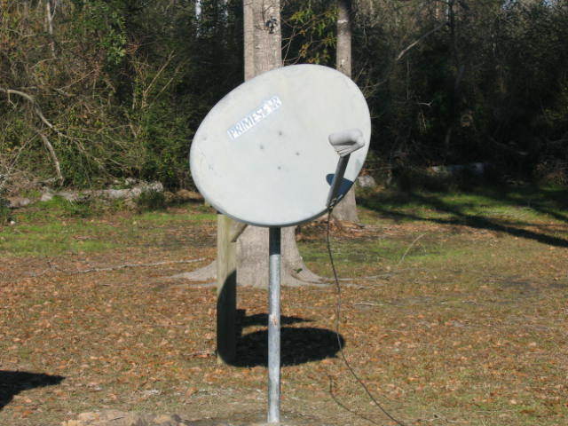

Just posting a little update.....got my 84e dish on the pole today...Its amazing how easy it is to hit a satellite when your mast is plumb....:D

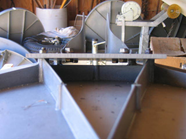

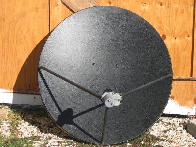

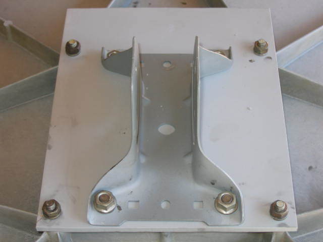

I also put the 1m round dish back together, used anti-seize on all the bolts, I attached pics of the mount that I cobbled together, just waiting on Friday when the motor gets here....:cool:

Nice pix.
Nice paint job.
Seems a little glossy, though.
I'm jealous. :)
I see you've been studying the homebrew mount designs.
That was the one that inspired me, too.
Is that a superdish foot you've got , there?

The paint was that Krylon Fusion paint for plastic. Said satin finish. I was disappointed, too. I may buy a can of clear flat finish if I can find it and cut some of that gloss.
The foot is off of a D* dish I had laying around. I have 2 P* roof mounts that I could have gotten the bigger foot off, but the sg-2100 will have the standard arm on it and I didn't order the 50mm arm, so I have to go with the D* mount. Only thing I have to work on is the jackscrew, but I have to wait until I get the motor to see really what I need to rig up.

What material is the flat plate ? If this is the dish you are going to put the motor on , remember weight is an issue .
