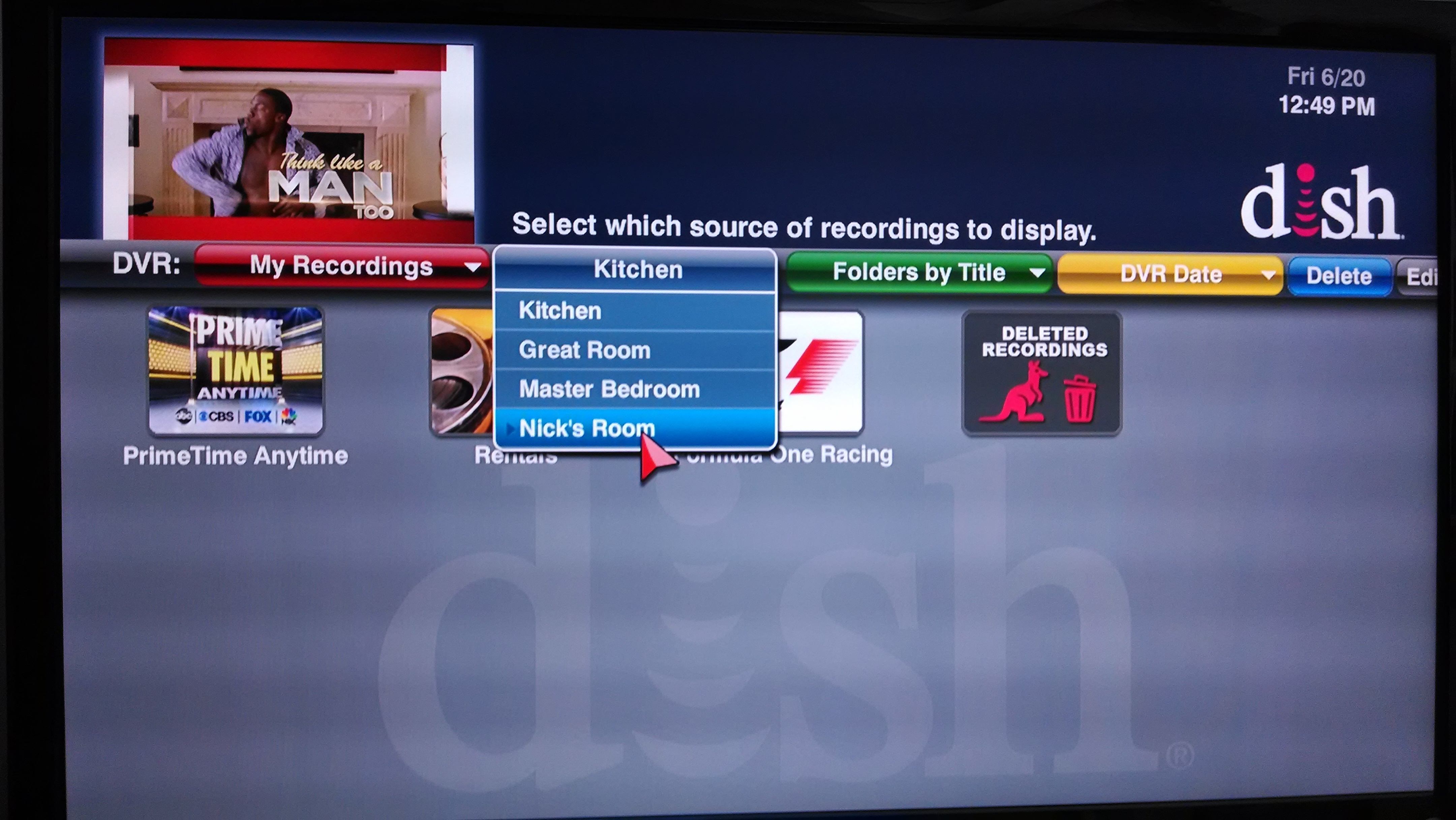

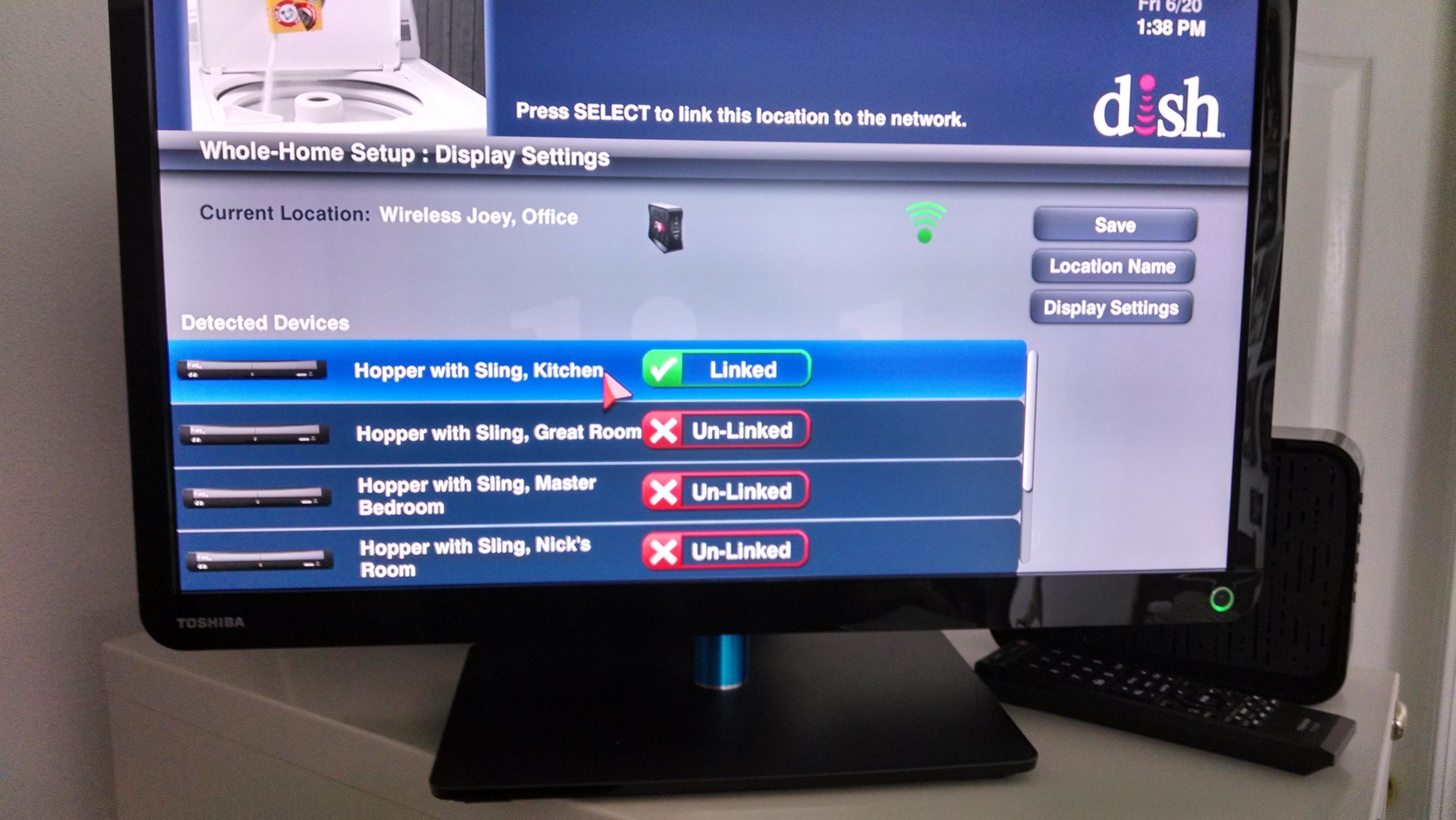

My Wireless Joey can select any of my Hoppers from the DVR selection dropdown menu. Also, the Wireless Joey can link to any of my four of my Hoppers. First pic is the DVR selection dropdown menu from my Wireless Joey TV. As you can see I can select any Hopper. Second pic is the Whole-Home Display Settings menu (Yellow - Blue - 4). As you can see I can link to any Hopper. My Wireless Joey Access Point is Cat5 attached to the Great Room Hopper. The Wireless Joey is linked to the Kitchen Hopper.
