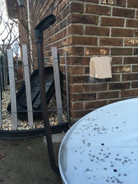

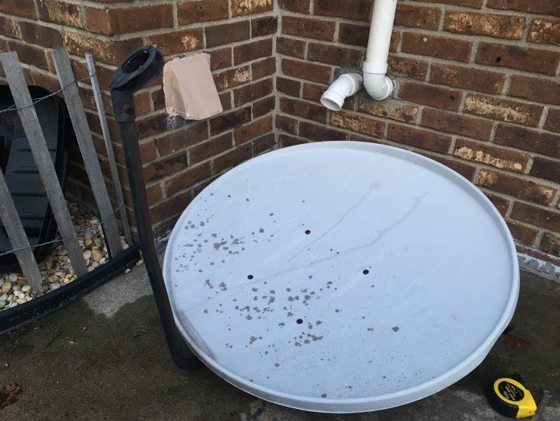

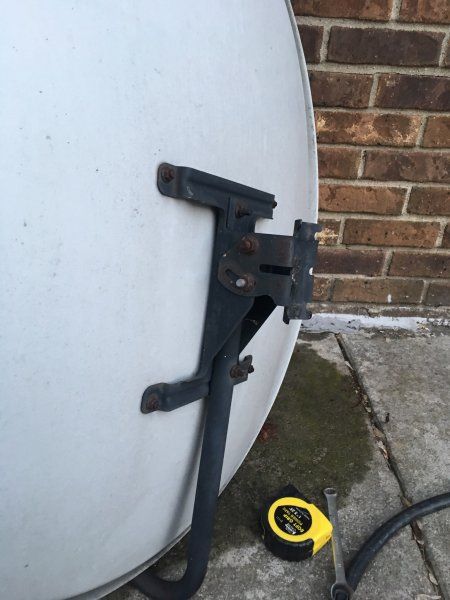

I got the dish. It's 31 inches across and 32 inches tall. The LNB arm is bent and it has no elevation or skew scale. How would I find my elevation?
On my wineguard, I just used my iPhones built in elevation scale. Would that work with this dish, or do I need to calculate the offset angle?
Looks like the mount might be missing something, but should be easy to figure out a solution. Do you think the bend in the LNBF arm is intentional or accidental? I mean, that tube does not look like something that would get bent too easily. The problem is, that LNBF holder is not adjustable, so if the bent in the arm brings the LNBF even slightly away from the focal point, that could have a significant negative impact on performance.
The lack of scale should not be a big problem. If you have some kind of meter with audio indicator, like the cheap $6-7 things they sell on Amazon and elsewhere, use that to get an approximative aim at a satellite, and from there, hop to the next one until you reach your target, by adjusting the azimuth and small adjustments to the elevation. Not ideal but certainly not a show stopper.
No, just the mounting brackets. I have them getting refurbished. This dish is old. It was on a J-Pole on a tree and bark grew over the mount. I couldn't get the mount off. It was down low, so maybe it was accidental. I don't know if the tube is bent or it's just bent on top. Is it a bad idea to hammer it down?
If you don't know if it is accidental, I wouldn't do that.
