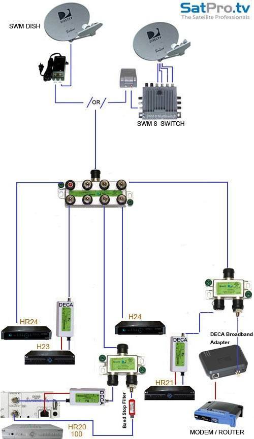

deca-diagram.jpg check this diagram out.
thats for the hr20, you have the hr21 correct?
Yes model is HR21-200 for the HD DVR.
I can't read diagrams worth a darn...I don't have that 8-way switch thing just a small one on the outside of the house and the power injector thing inside.
