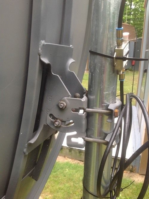

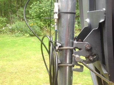

If that is the place. Doesn't have much in the way of specs but it looks like a fat tube. Anyone confirm that the tube is at least 50mm? And If I recall correctly that is the motor that is mounted upside down. I'm at work now but I'll have to check the bracket on that dish. I don't remember if there is a little lip on the bracket that might have to be ground to work with a topsy turvey motor or not. The HH120 is a good motor, eh?? This is a pretty hefty little dish.
If I recall, the first WSI 1.2 didn't fit a motor too well.
Post a couple of pictures of it.
?Might save you some trouble.

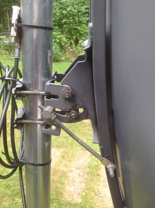

Looking at it a bit closer and trying to crop these pictures I'm thinking the STAB would probably work. There is a little lip on the top of the bracket that I actually bent upwards on the original install to slide over the top of the post. If I bend that back down that will help hold the dish on the new motor while I tighten things up. BTW the elevation adjuster was a homebrew. The larger dishes really need to come with them to being with IMO.

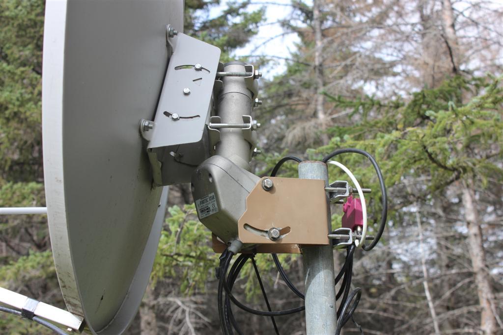

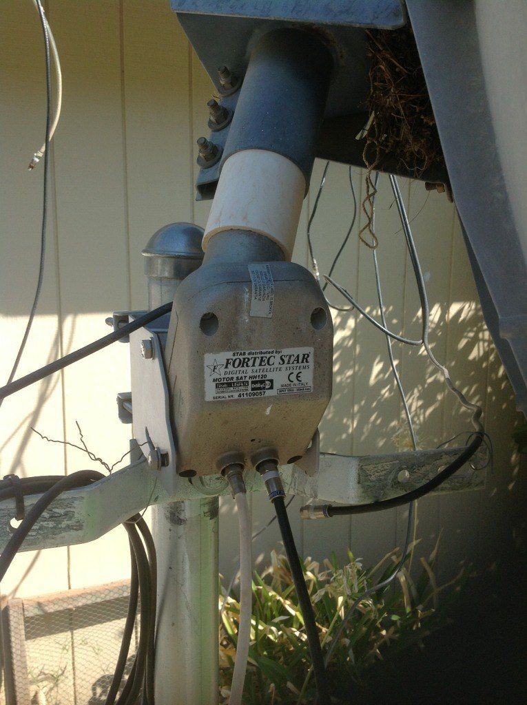

I notice in your picture that it says "Fortec Star" on the label. I have seen others that say "Stab"...
I'm looking for one for my ChannelMaster 1.2, and I'm wondering if we're in the same boat with the HH120 as with the SG2100 motor.
Are there "real" HH120's and "clone" HH120's?
Just wondering, how long have you had your unit, and where did you buy it from?
?Thanks...
The larger dishes really need to come with them ...
Yea, I think only the GeoSatPro 1.2 from SatelliteAV has such an adjuster.
Well, so do molded Prodelin and Andrew, but they're too heavy & expensive to put on the motor.!.! ;)

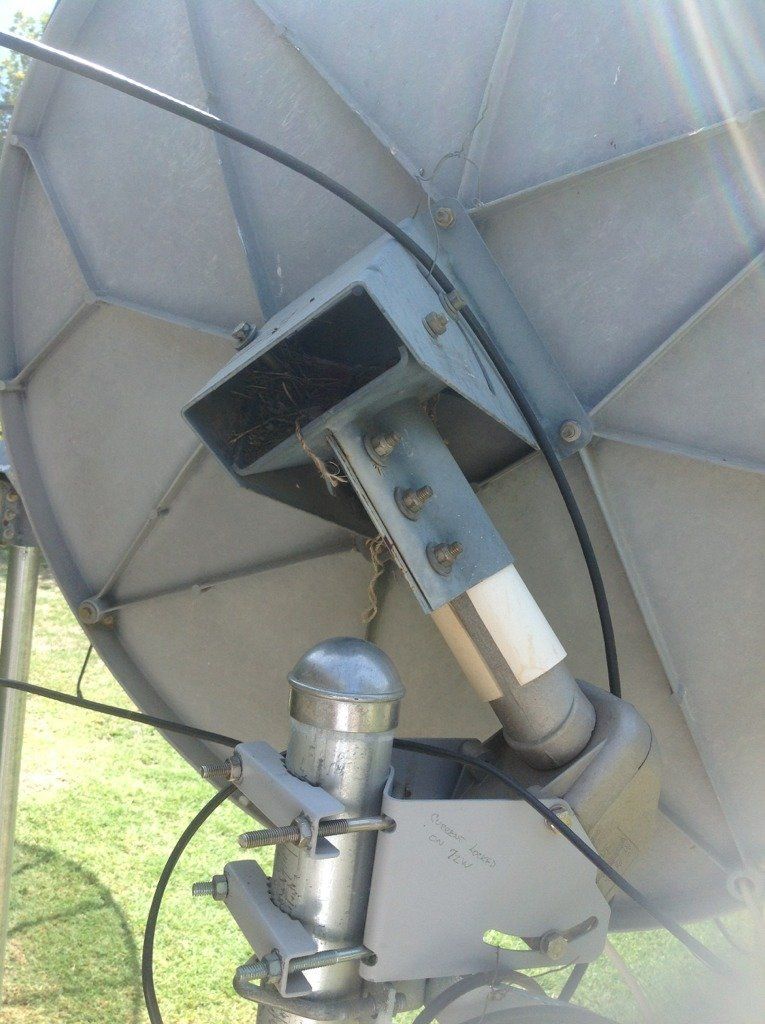

I use a STAB120 I purchased from Sadoun several years ago. It's got a Channel Master 1.0M dish on it.
You'll notice I had to shim the STAB sleeve with a length of 2" PVC I cut lengthwise which works fine. That 1M Channel Master is a heavy dish. I also have a 1.2M channel master, but not using it anymore.

You made me go out and read the label on mine. It is a STAB distributed by Fortec Star (Sadoun I bought from (or was..) I think I bought it around 2003 or 2005? Time flies...
Still has the unbroken seal...
Ignore the flat horizontal steel brace below the STAB bracket. I used that to hold the motor bracket when I was setting it up, and left it there. It makes motor mounting very easy.
