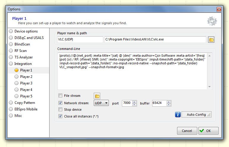

How did you setup Vic so you can watch tv I am having trouble between VLC and EBSPro
Select 'Options...' from the File menu. Then on the left side of the dialog click 'Player 1' under 'Integration'.
After that click the yellow folder icon on the upper right side of the dialog and locate your 'vlc.exe'. There are streaming options I also selected at the bottom of the dialog (attached screen shot).
