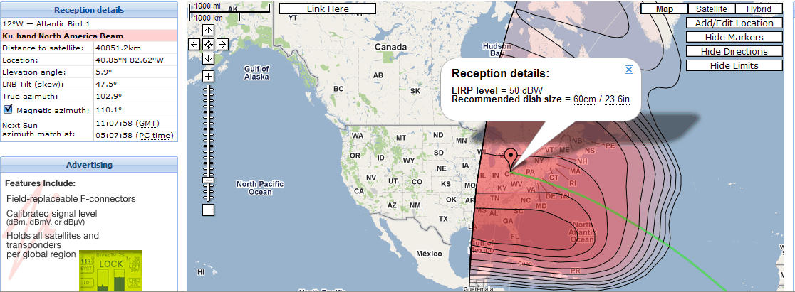

I can vouch for Hindu55, as we have discussed Atlantic Bird 1 at 12.5W in this thread:
http://www.satelliteguys.us/free-air-fta-discussion/194203-satellite-dxing.html
Mike Lib
Very easy to get satellite 12.5W Atlantic Bird 1 in Ohio... Refer to footprint below.
RADAR
