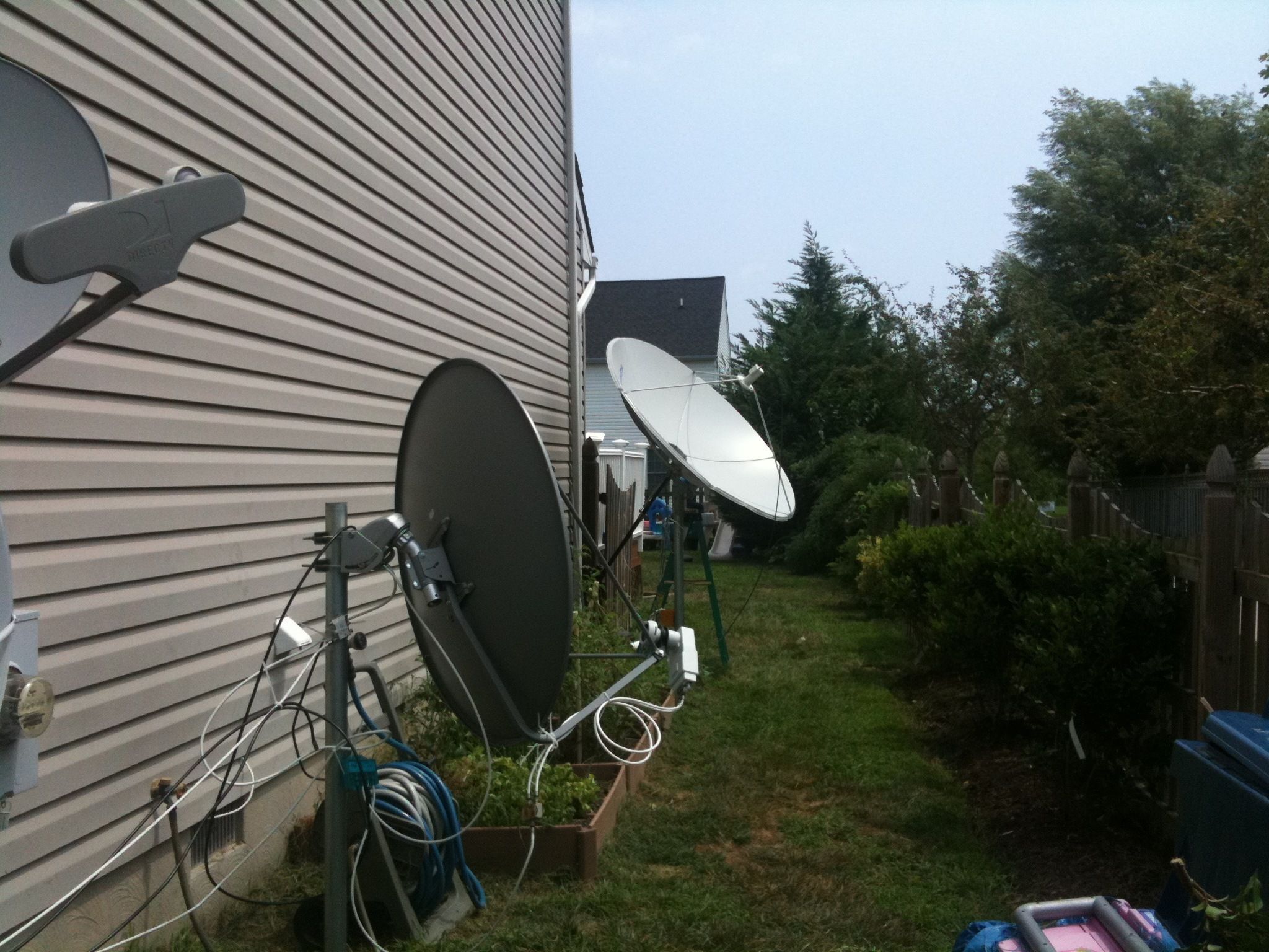

Well here it is. Finally in the ground and on the arc. I'm still fine tuning the actuator, but having good luck thus far from 72W to 99W. I have to admit, the Fortec polar mount was a challenge to get figured out.
The pole is 36" from the house. The dish is on a 2.5" ID (2.875 OD) pipe, I had to construct a set of steel shims to get the mount nice and snug. Also, I had to replace a the nylon lock nuts with a lock washer and nut to get some of the movement out of the mount. As I recall the dish was pointed at G-17 in that picture.
