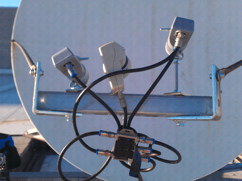

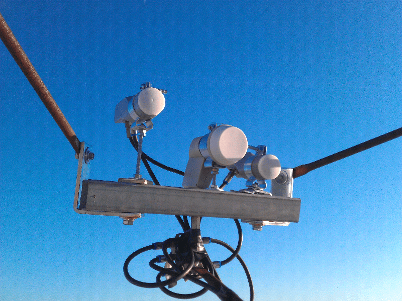

I will snap a better picture of my lnb mounts today. The arms on mine are intact, but the clamp was broken. I improvised, knowing I was going multiple feed with it.

I have 3 of these dishes setup out in the yard currently and converted to C band. Each has the same reflector but varying mounting configurations. If you need any photos of the mounts or hardware let me know. Two of mine came with the NPRMs and one didn't and is now mounted on a 4" pole. One thing to keep in mind is that these things are heavy to work with.

I am finally able to post the pics of my prodelin lnbf mounting method.
It is not a pretty install, but it works with parts I had on hand, unistrut, conduit clamps, threaded rod, and 1/4-20 hardware.
