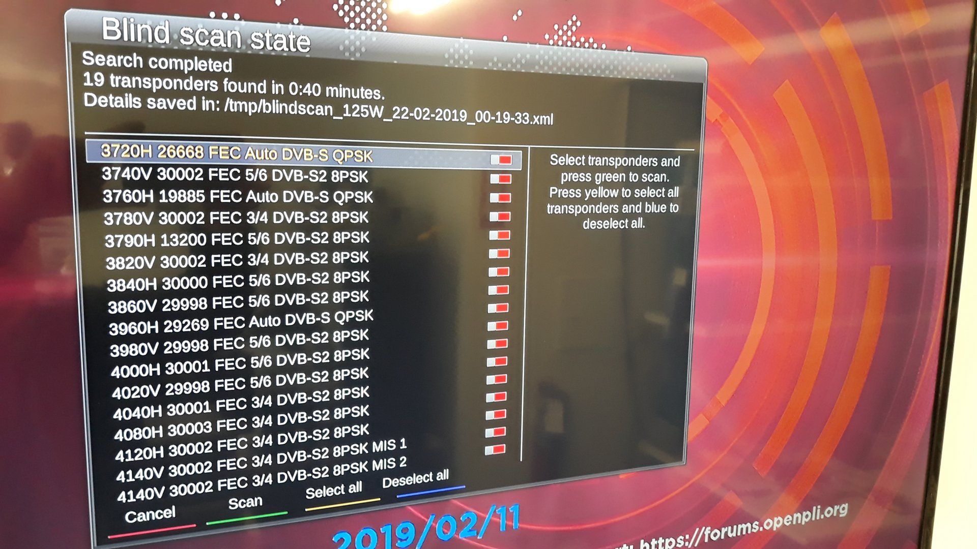

In general, I think the GUI is more intuitive and customizable. It's also the only image I've found so far that allows a 12-hour time format for the on-screen display. The blind scans have found all available TP's every time without fail.

Once it does the blind scan, it also gives you the option to choose which TP's to scan for channels before it looks for them. This is useful for eliminating known data feeds such as those on 87, 91 and 103. I believe OpenSpa might also have this capability, but I don't recall.
Most images allow this selective service scan. In Blind Scan mode, change the Search Type to Scan for Transponders.
In this setting, the Transponder Log process is completed then a second screen allows the user to exit or select TPs before performing the service scan.
