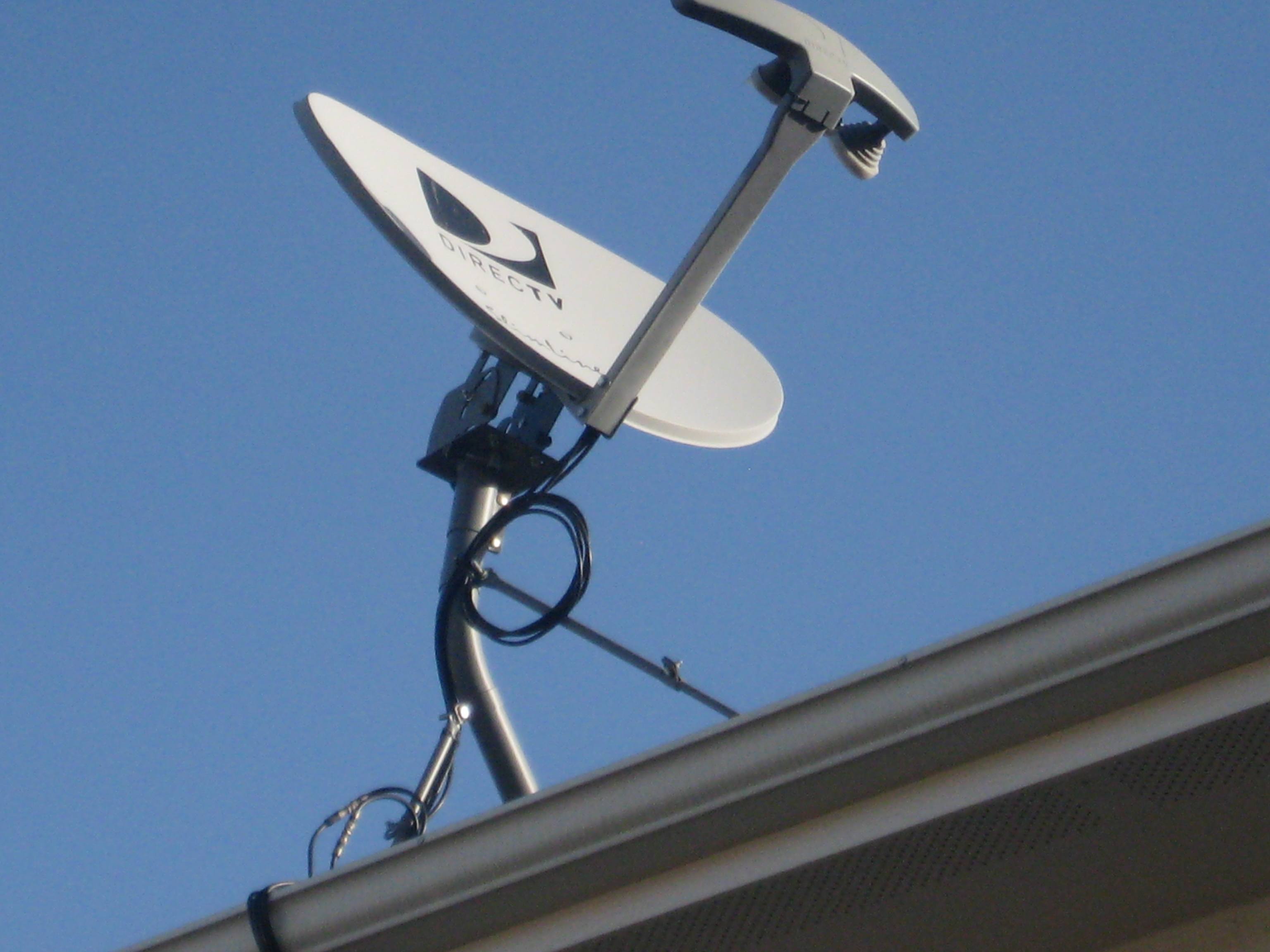

I am going from directtv to uverse. Where can I hire someone to remove the dish and tripod? Any ideas? I would like to sell it as well. Its on my roof and is DIRECTV Slimline Dish. Any help appreciated. Pdf is picture of satellite on my roof.

Craigslist maybe?
The dish won't be worth much as I can see that not only is it not SWM, it is at least a couple years old.
Also, keep in mind that the mast and arms will be missing the foot plates as they should be left where they are because they are keeping your roof sealed.
Not that it can't be resealed but if the installer used bishop tape like he should have, it will rip the shingle up with it if you attempt to remove them.
Considering that I can buy a complete set up brand new off ebay for $75 or get a free one by dumpster diving at my local Mastec office, used ones or really worthless.
But, you could try selling it on ebay, it might be worth a few bucks to somebody.
However, instead of worrying about selling it, how about just climb a ladder with a 1/2" wrench remove it yourself.
You won't even have to leave the ladder and you will save more money then you will ever make off the dish.

Try this: Find Local Satellite Installers.
or there may be some installers on the installation site....Directv Installation Support.
Suggest you leave the mast & pole bases attached to the roof to avoid leaks. Remove them when the roof is replaced. The other way to patch is to have a piece of shingle to slide under the holes made by the lag bolts.
+ as mentioned...these things don't have much street value.

LOL, bad for the environment?
How is it bad for the environment by sitting on your roof waiting for you to come back to Direct TV or the next home owner to sign up vs sitting in a land fill only to never biodegrade?
I think leaving it exactly where it is would be the best thing for the environment.
Regardless, if you have environmental concerns but want it removed then take it to a recycling center when it is removed.
If you get the roof redone the roof guys will take it down. Just tell them not to put it back up

Actually, you OWN it and can do whatever you want with it, including put it out for the trash, someone will probably come by and get it before then anyhow.
