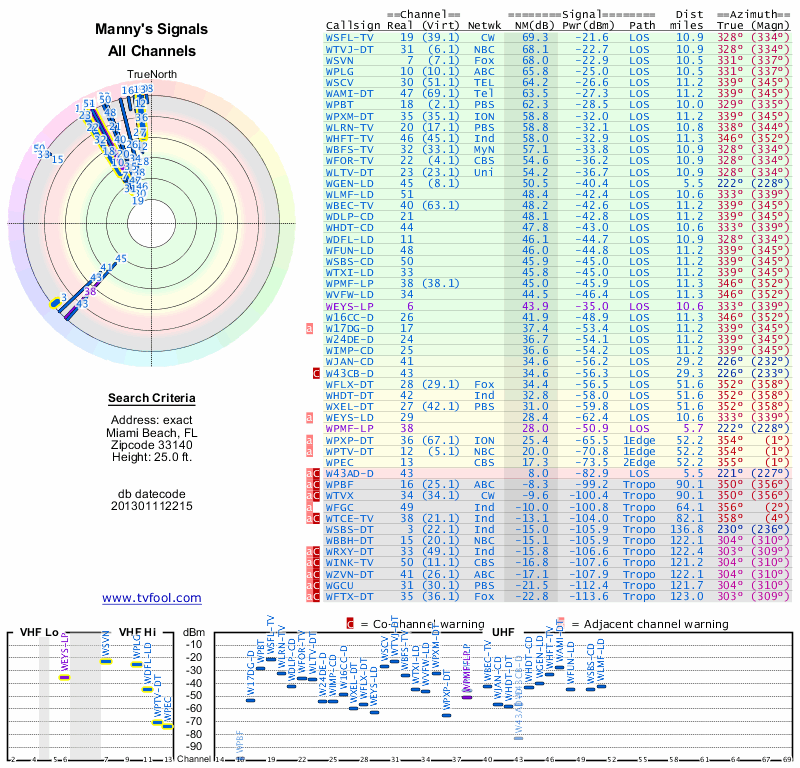

Checkout tvfool.com (TV signal locator) and see what it recommends for your address. You can post your results here and get feedback on different antennas that people here have tried in similar situations.

Your tvfool reports seems to indicate all the locals in green would be easy to pick up, without a huge antenna. If you want the distant ones yellow+ you will need a bigger one. But, it looks like you have the big 4 close and easy to pickup. With the transmitters less than 15 miles away I would not be surprised if rabbit ears work.
The best bang for the buck antenna that will supply both a robust VHF & UHF signal is the HBU-22. You could use the more expensive ANT-751 if aesthetics are a concern & achieve just about the same level of performance. The ANT-751 should be available locally at most Walmart & Best Buy stores. The HBU-22 should be carried at most Radio Shacks. Both are available online for about half the price if you don't mind waiting a few days for delivery.
All of your local signals are coming from the antenna farm right next to Dolphins stadium. You have a LOT of receivable channels that should be very reliable with the RIGHT antenna.

Your tvfool looks way better than mine and I live in a valley with mountains and ridges. You can look at my thread and see what I am dealing with. I'm sure you wouldn't need antenna facing different directions but you can buy the ANT751R from Walmart shipped for like $37.95. They were out of stock so I paid a few dollars more from Amazon as I couldn't wait. I can vouch for them, they work well as you can see on my reports from tvfool and antennaweb.org, your distances are half of mine or more.
