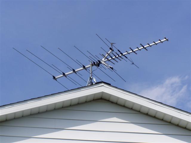

I installed a winegard hd7082P with hdp269 amp for the parents this past friday btw. My parents had trees. Was able to find a spot on the roof where the antenna shot thru a clearing. Works great split to 5 tvs and no distribution amp. The hdp 269 tooks its place and there was no overload 8 miles fom towers.
tried the 7080p there, but the 7082p was better for their multipath issues.
