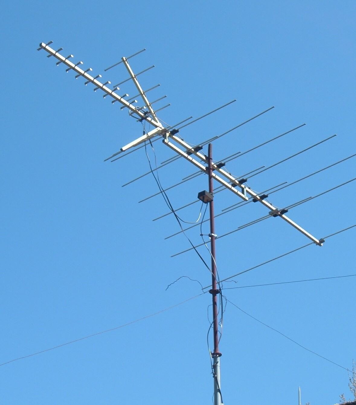

My antenna is 20+ ft in the air and was here when we got the house. I have attached a picture below. I am going to go up (as soon as I get a ladder) and rewire the thing (there is some wiring issues with this as I can fiddle with the wire and get better/worse performance.

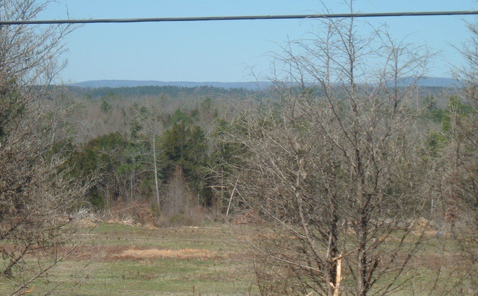

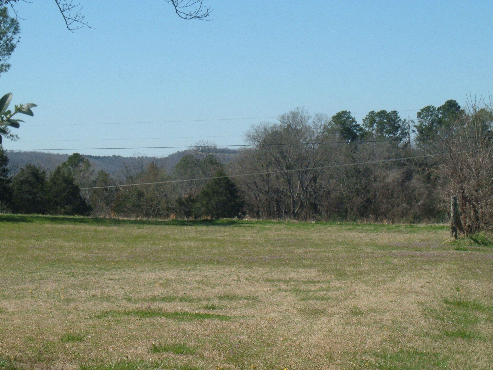

The 1st Picture is from the antenna location to the west and the 2nd picture is to the north. 3rd picture is of the antenna.
I have mountains pretty much all around (although they are a ways away and the transmitters are located either on them or on higher mountains).

Definatly going to get the rewireing done. I have noticed some issues with it. The Channelmasters 7777 amp is a good idea too. I have to get a ladder to get everything checked out though (either that or remove all of the guy wires and drop it down. The people that lived here before ran 4 guy wires to the antenna.

Looking at the picture myself (as I havent gone up to check it out) it almost looks like one of the wires is going to the vhf hookup and one is going to the uhf. That would be fine but we only have the coax going into the house (in other words the other hookup dosent appear to be going into the house at all).
1 of the leads is the 300ohm flat cable and the other is rg6 (we have rg6 going inside the house).
UPDATE I went out today and the 300ohm cable is not hooked up at all (it was behind some bushes and was cut). So that might explain some of the problem :D
I didnt notice it until noted the 2nd lead above.
I am going to pull it down and look it over to see what is messed up on there. Something isnt right. Now I just have to find the time to do it.
It looks from the picture like you have a amp on the mast as well. Do you have the inside portion of that plugged in? (I know, a dumb question, but previous people may not have left that for you.)
The wiring looks like it needs to be replaced, in total (as others have mentioned) and the removal of the 300 ohm will not do anything but help you.

I agree a rewire is definatly in the works. There is no "inside" portion to the amp to plug in. (or if there is it wasnt left here when they moved). So thats not a stupid question in the least.

You may as well look into getting a pre-amp, so that when you are rewiring and installing your rotor, you can go ahead and attach it to the new rg-6 at the antenna. The channel master 7777 is really recommended on here (lots of happy users), is pretty affordable, has a good gain / noise ratio, and easy to install while you are at the antenna (the one part hooks up to the leads on the antenna, downlead cable to the house from it, then close to the TV, you plug in the power unit and then put in-line and run to back of set or STB.)
Most people recommend pre-amps when you have long runs of cable from the antenna to the STB or receiver (over 50 ft.), but I think in your situation, you really don't want to lose any of the signal from any length of run (over 25 feet, I would think.) It will not get you any better signal to the antenna, but will keep you from losing what you do get on the way to the set.
In looking at blowup of your picture, you definitely have a pre-amp up there. Kind of even looks like a CM. But if there is no indoor section, I am surprised that you would be getting any signal at all. The kind of situation you have, running to outdoor pre-amp, then directly to the tv is a real signal killer. So as recommended, you can install a 7777, but from what I see, maybe just disconnect from the outdoor pre-amp and run directly from antenna to the tv. This might accomplish what you need. Also disconnect and discard the flat 300 ohm cable completely. It is just junk. Are you sure that the coax is RG6? It could be just Radio Shack junk. If so, get rid of that too.
I will know a bit more when I get up there. It did look like RG6 from the bottom (its marked as RG6 on the part that comes into the house). I will know a bit more when I climb up there to get a good look. I have to get a ladder (and time) to do it. I am going to try to get it done this weekend. The 300 ohm cable will be gone (as I noted above its not even connected to anyting, it was just lying behind a bush (cut)).
