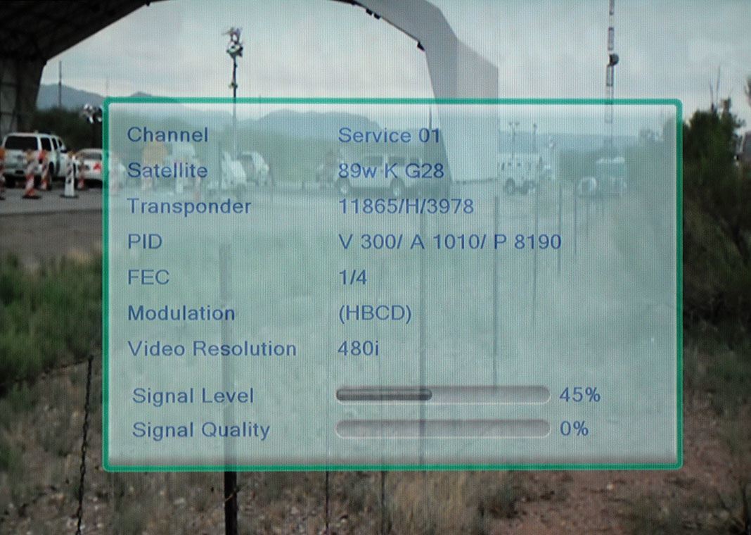

When blind scanning I have come across two feeds with a modulation listed as "HBCD" and a FEC of 1/4, what modulation is this?
the only time I see that is if I hit the info button to bring up the "big info" screen and it hasnt locked the signal yet

Sorry, Brian, I have a go-back on this one. I scanned some feeds on 103W yesterday. Didn't notice the parameters at the time, but when I looked at them later, the feeds were gone and the info screen showed (HBCD). I've reconfirmed that now that I'm back home. I'm doing a detailed blind scan now to see if I pick up anything new.
Edit: nothing active right now showing HBCD.
Do you think that would change anything, the feed being gone?
Here's a news feed from tonight,
The feed died but froze the last frame, the info screen still pops up. (It's actually 87W, I put horizontal on 89W. )
