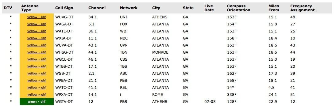

Here is my Antennaweb.org chart showing that I'm about 20 miles or so from all the Atlanta HD OTA signals. Yes, I have DirecTV's local HD channels, but trees are causing issues with that. And I want a "backup" plan. At any rate, my Samsung LCD tv has a built in HD-OTA tuner and so does my DirecTV's H-20 receiver.

I would use the winegard HD7084, great ant has a 60 to 80 mile range runs about 80.00, there are smaller ones I have had success with this one, great success. Bigger is better. Have seen terk ones 20 miles is pretty close if you get a better/bigger one you might pull stuff from other cites, IMO. There are ant suggegtions All over this site. Small questions are inside outside , two story or single, are you handy or not, will the wife let you put it on the roof or not. The wqay you want to mount it and where is a big element as to which one. again 20 miles is close. Peace
Ok for some reason my server is being goofy, so I just attached the chart.
I don't care where I put it, but if I do it myself, I have a two story house and I'm not super good at getting way up there with a ladder.
And as far as far out stations, sure, it would be cool to get HD OTA stations for further away, but really I'm more focused on getting just the locals here...

You can not get anymore than you have in ATL.
Mount in the attic. Or call an installer.
Trust me you will not have any problems with any of those antennas these guys have suggested. I live in Jackson Co. about 1 hour northeast from Atlanta and my set up is... CM3020 unamped with RG-6 to ground block straight to the tv in on my Hitachi. I am able to pickup 2.1, 5.1, 11.1, 11.2, 17.1, 36.1, 43.1, 46.1, 34.1, 34.2 and some Christian channels in HD. All range between 50% to 90% signal quality and have not had any problems.
