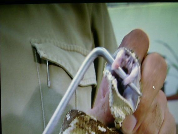

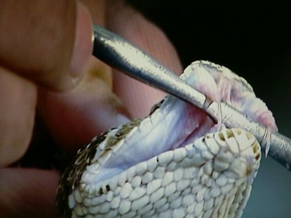

Before you purchase you a PC USB or PCI device I'd make sure you can use it in the DVB programs you want especially TSReader. TSReader and VLC is hands down the easiest way to watch HD and 4:2:2 feeds. There's a thread with users having hit or miss success with TSReader on the DVBWorld USB device.

I never said it couldn't do it. But without support in DVBDream, RitzDVB, TSReader(without crazy workaround), I'll pass on the DVB device.
What codec are you using for 4:2:2 HD? What kind of performance do you get with it on your rig?
I use the all original software that comes with the DVB World receiver, it has worked flawlessly since the moment I loaded it on my computer. No cut outs PERFECT HD and 4:2:2, only time it drops out is when the signal gets too low and that's only once in a blue moon!
I understand why advanced users like yourself would want to use the above software but most users just want to watch HD and 4:2:2
And that's what my DVB World has been doing from day one. Plug and play.
I am still kicking myself for not getting round to using it sooner! It sat on my desk for nearly a YEAR! I missed a year of FTA HD and 4:2:2
I LOATH to watch SD these days! (But I do :eek: )
