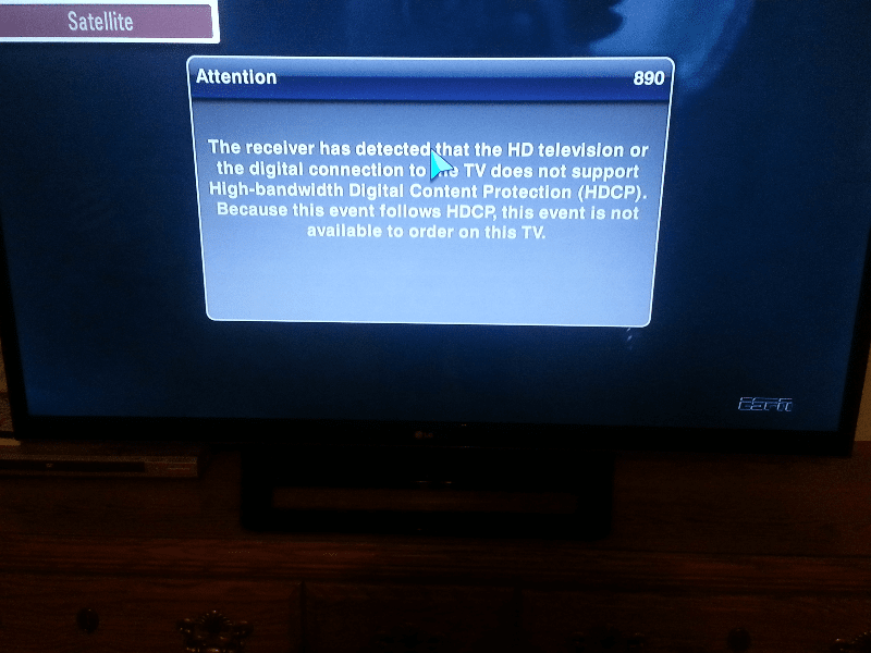

What does this mean???
Safe to say this only applies to receivers that support HDCP? Someone with a 522 or 311 wanting to watch those channels will still be able to, I hope.

HDCP is High Definition copy protect. The standard definition output does not have to be protected.

That message doesn't mean he needs an hdmi cable, it means he's using one. His tv isn't hdcp compliant or if using a switch or splitter that could be causing it. Remove hdmi and use component and the issue goes away. What tv make model and year manufactured?

Actually, it could be caused by a bad HDMI cable.
You say "you need HDMI cable connected". Meanwhile, i experienced exactly opposite. Customer had 612 connected with HDMI and mirror TV connected to coax output. HBO channels would give him this message on mirror Tv unless main TV (HDMI connected) was on. Solution was to replace HDMI with component+optical.
