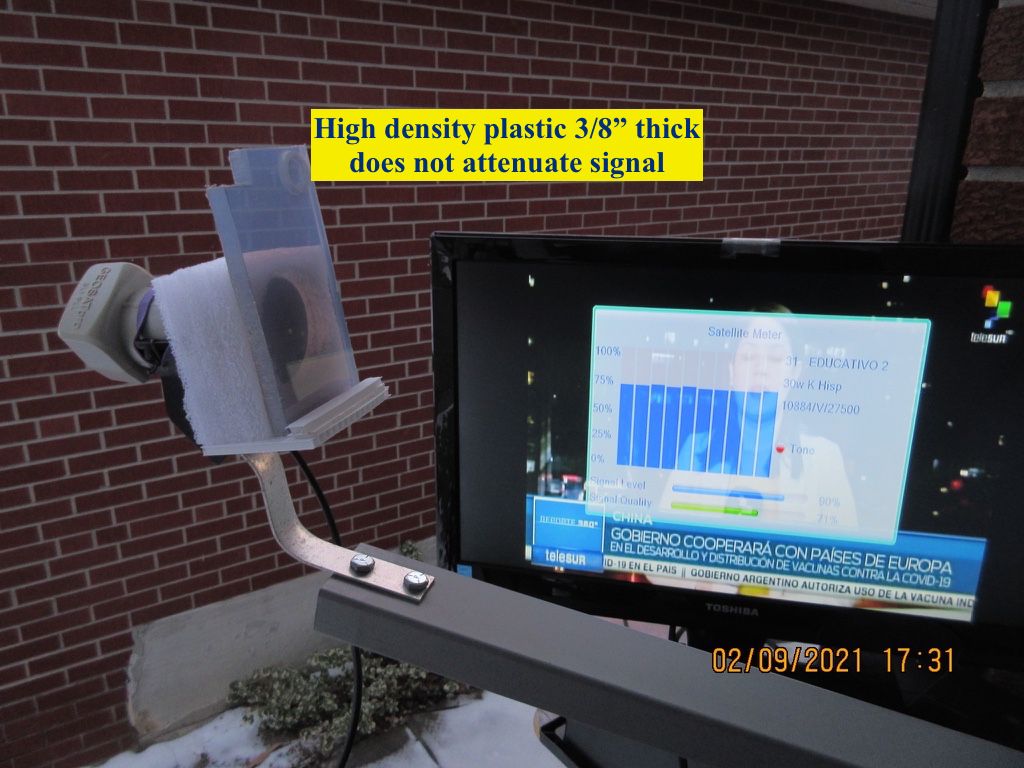

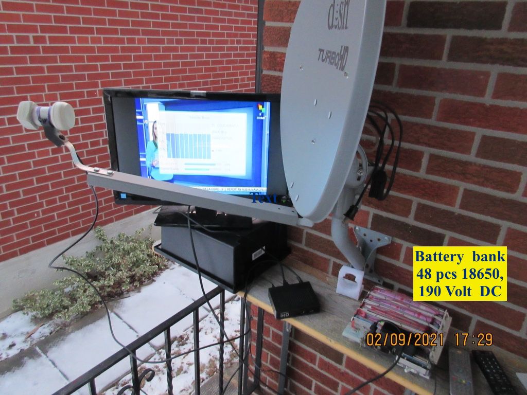

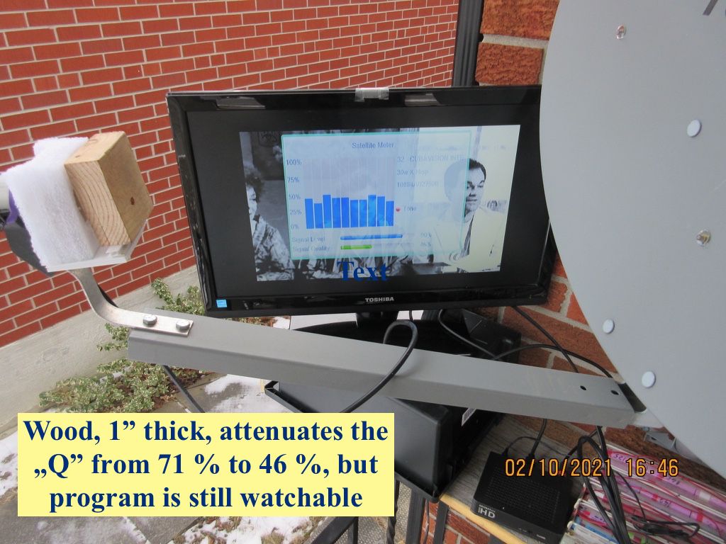

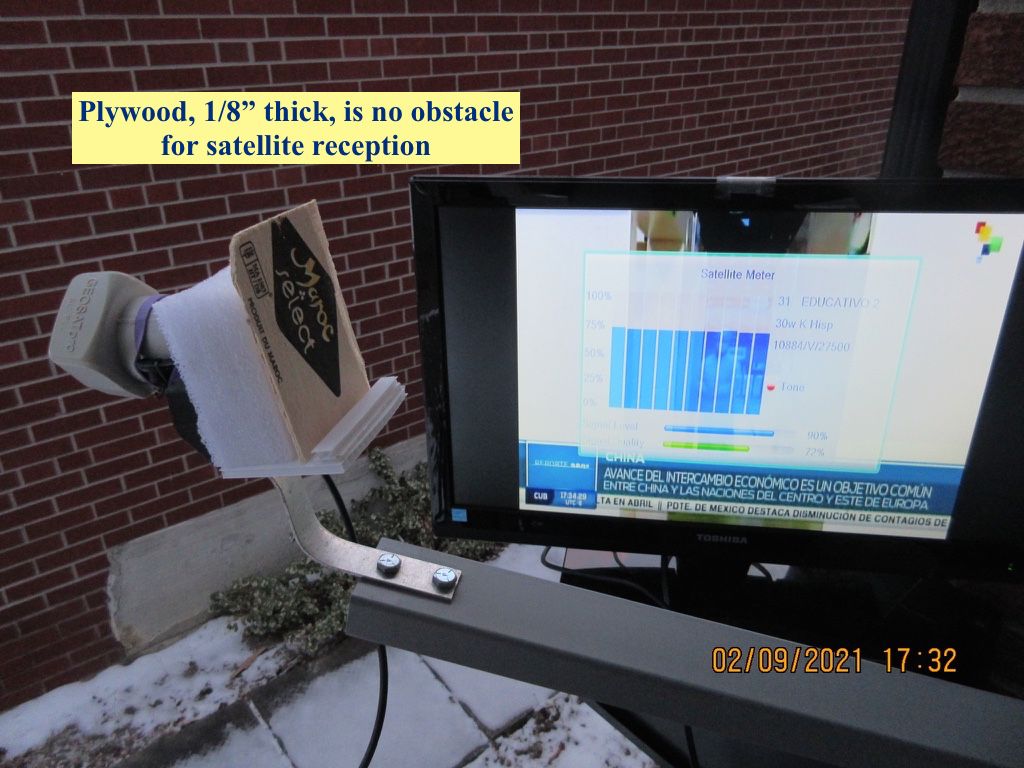

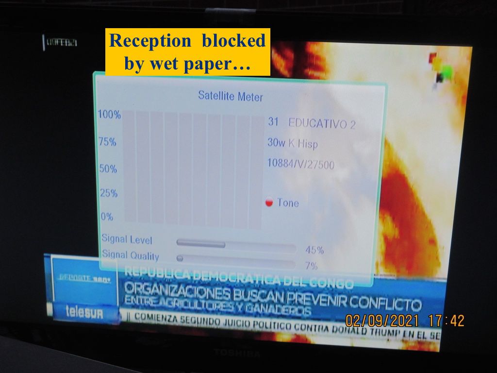

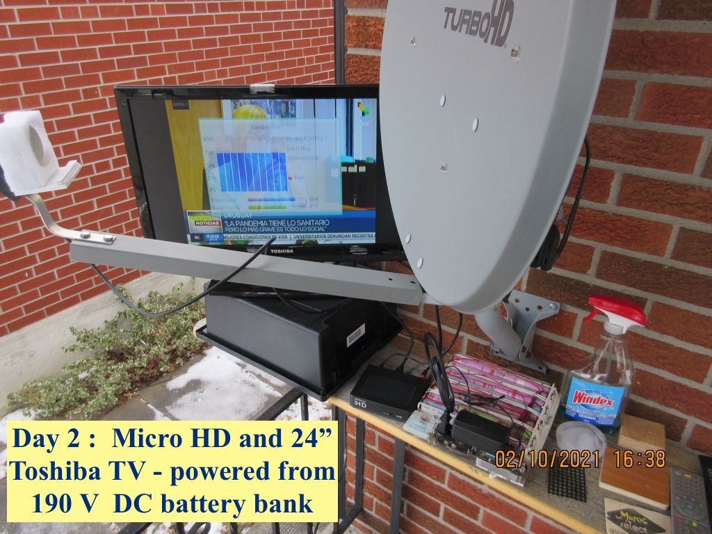

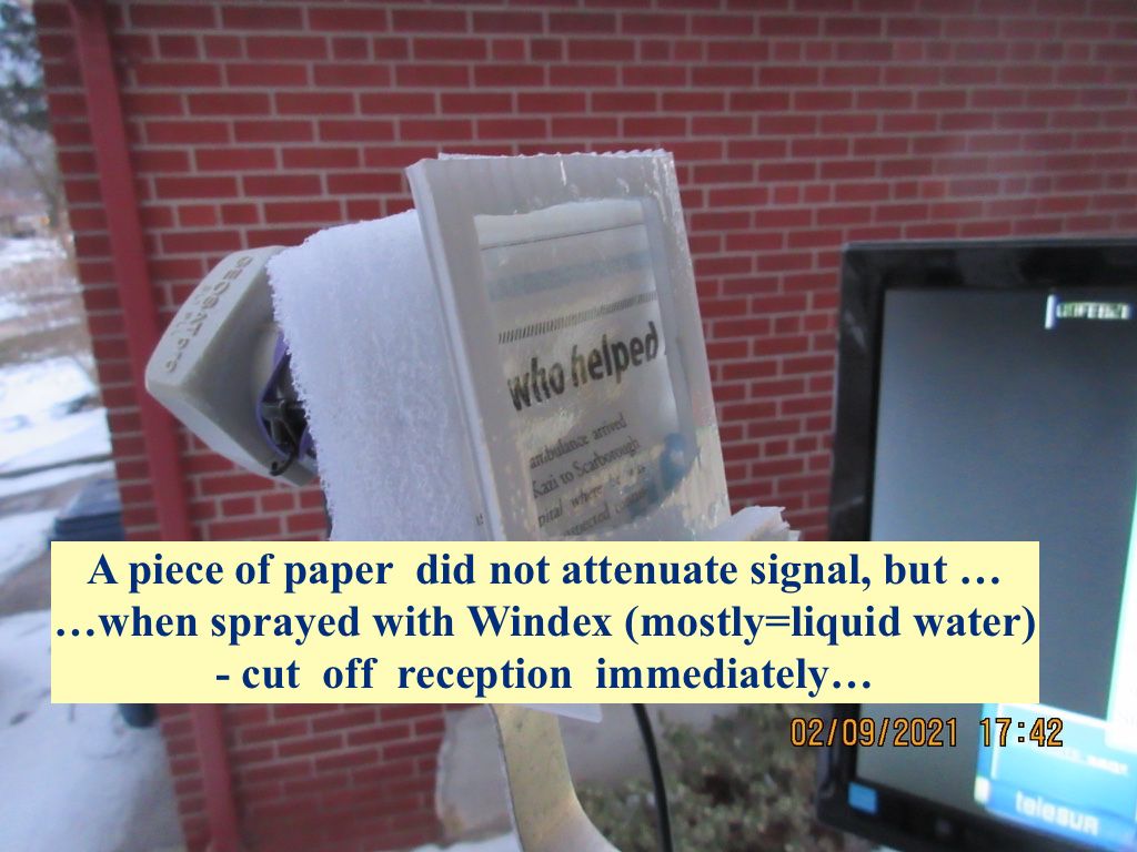

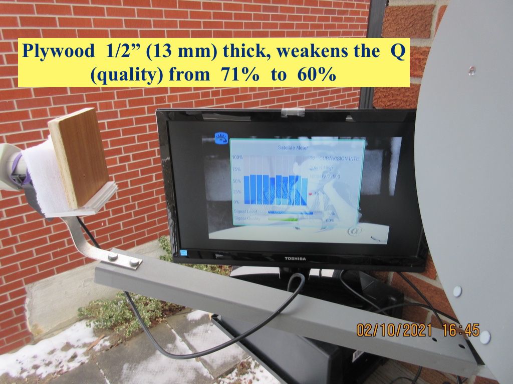

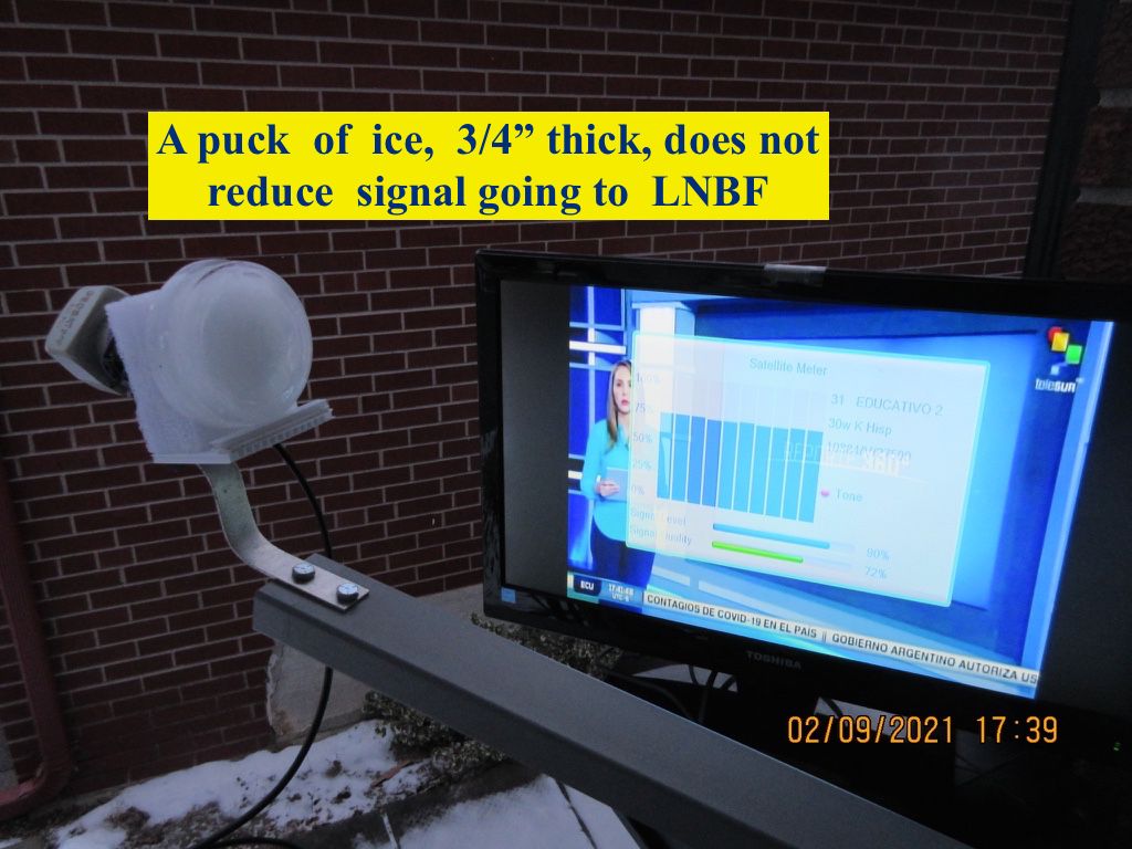

Some dry items when put in front of LNBF do not impede reception of satellite signal.
Of course, metals, even as thinniest foil, will cut off the signal completely.

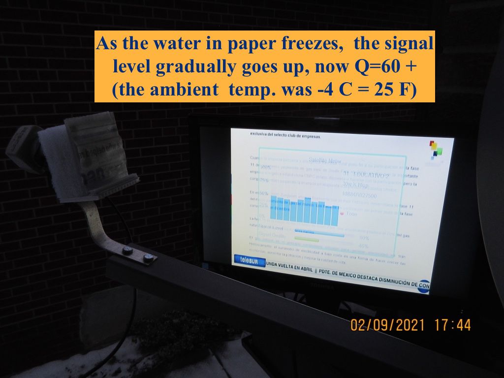

I was curious about water in its different forms : now I see that thick block of ice
does not impede reception.
But water in its liquid state - even as a thin layer - does block signal.

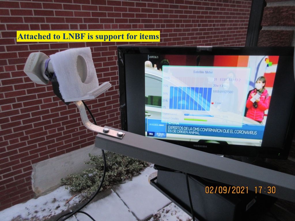

Annotated photos follow :

Snow does a good job of attenuating the signal also. I've never heard of ice never attenuating C or Ku signals. When I worked in the satellite industry they used heat blankets or forced air systems to keep snow and ice off the dish.
Brilliant testing, polgyver !

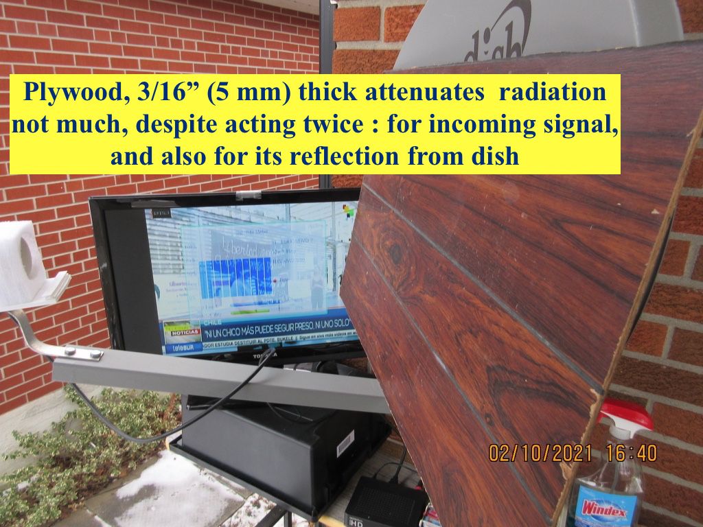

I'm amazed about the plywood. Good to know, for people that cannot have a dish "in sight" on their balcony...
I once had a dish behind a window. Worked OK, but when it rained and a layer of water was on the window, reception was bad.
Of course, this was a window without metallic layer on the glas.

Snow in my C Band dish doesn't attenuate the signal much. But once it starts to melt and turns to slush, the signal drops way down.
I once read in Coop's Satellite Digest about a guy who had a C Band dish in his garage (wooden structure). I was skeptical, so stuck a piece of 2x4 in front of the feed. It didn't make much difference. Then I tried another piece of 2x4 that had been sitting in a puddle of water. It completely blocked the signal.

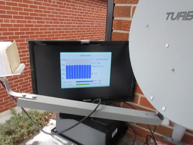

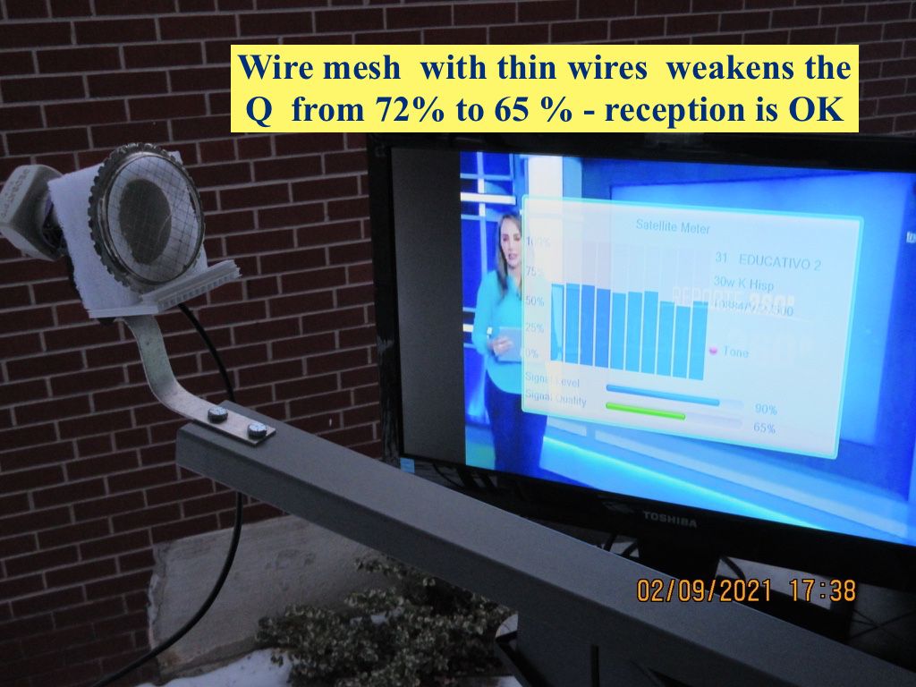

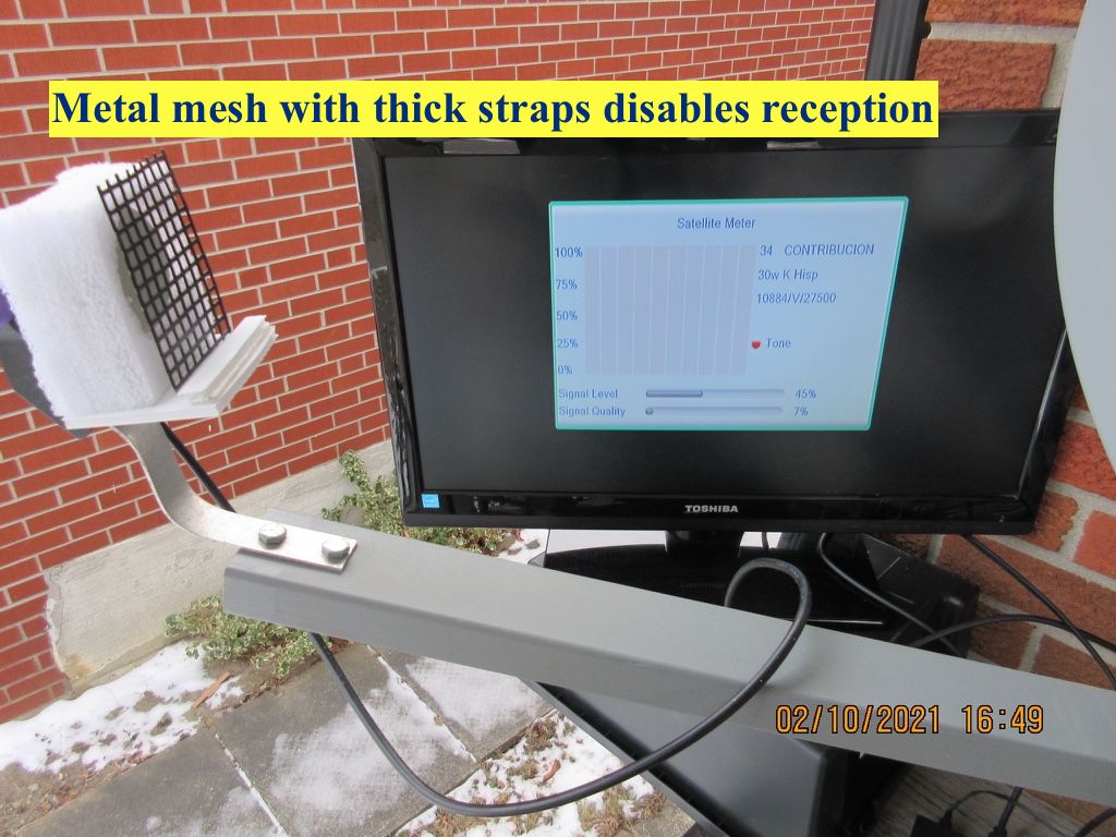

Today I continued with trying other items as signal obstacles.
Wire mesh, thin or thick, has no practical value for us, satellite hobbyists, but for curiosity I tried them both. Thin plywood or non-transparent plastic might be useful for concealing a dish.
Cheers, polgyver.

Might try different paint types on that thin plywood too, some might be more or less RF conductive.
People put TV antennae in the attic and they seem to work. Sat dish might as well as long as there are no nails, metal flashing, etc in the way. Wonder how an adobe roof compares to shingles?
