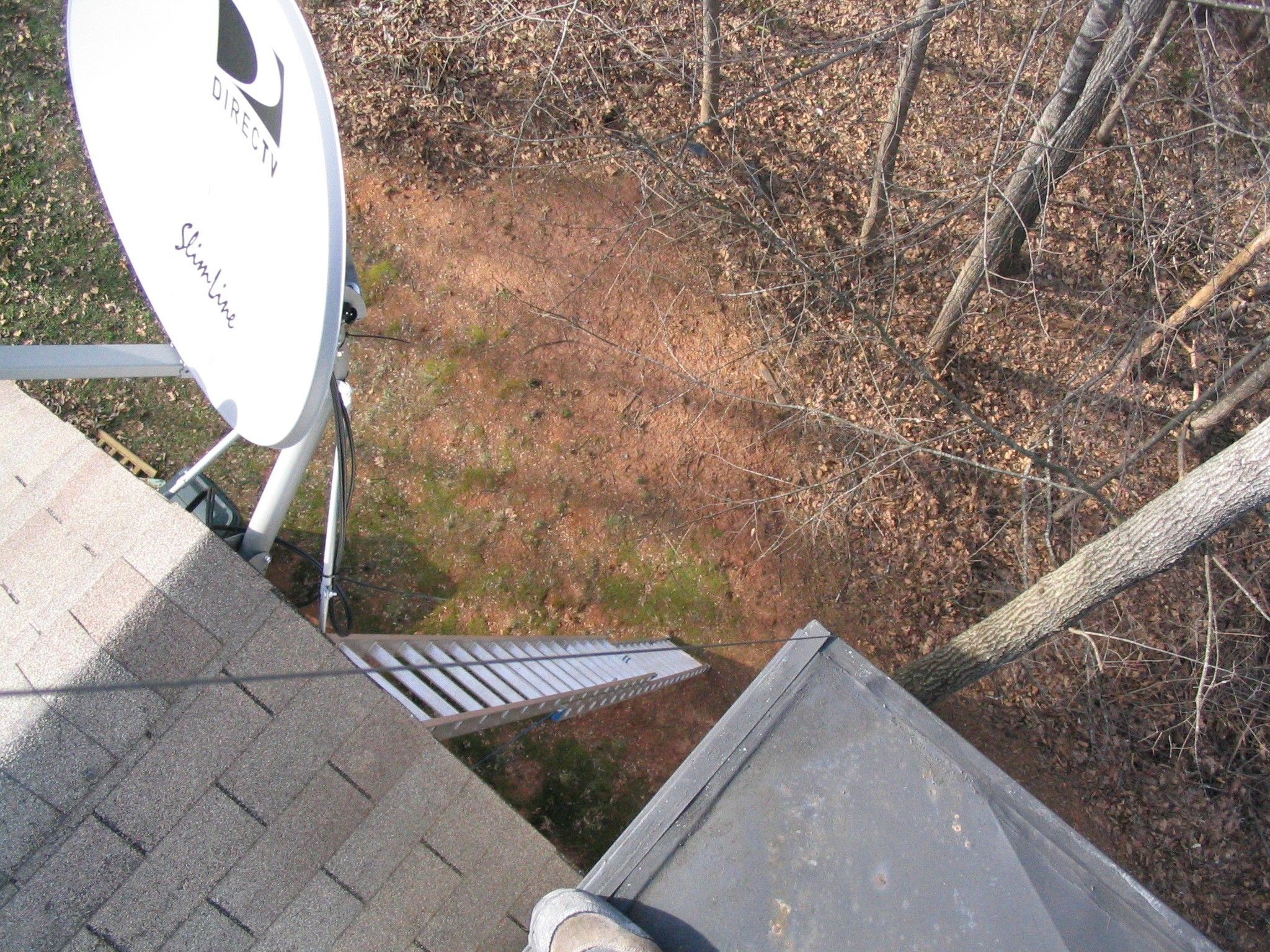

Heres a picture from the top to the ground.

Damn! You know what...I'm totally with Van on this. After seeing your last picture, I see no reason why you couldn't get a tripod mounted on your roof.
I was a bit concerned that your rooftop was higher than a standard 24 foot ladder. Judging by your last picture, there should be no reason why a tech couldn't get on your roof and install a tripod'd dish. Even if there's a LOS issue from the current D* location, a tripod will give you a 3 - 5 foot boost
Fantastic idea!....A tripod would work
