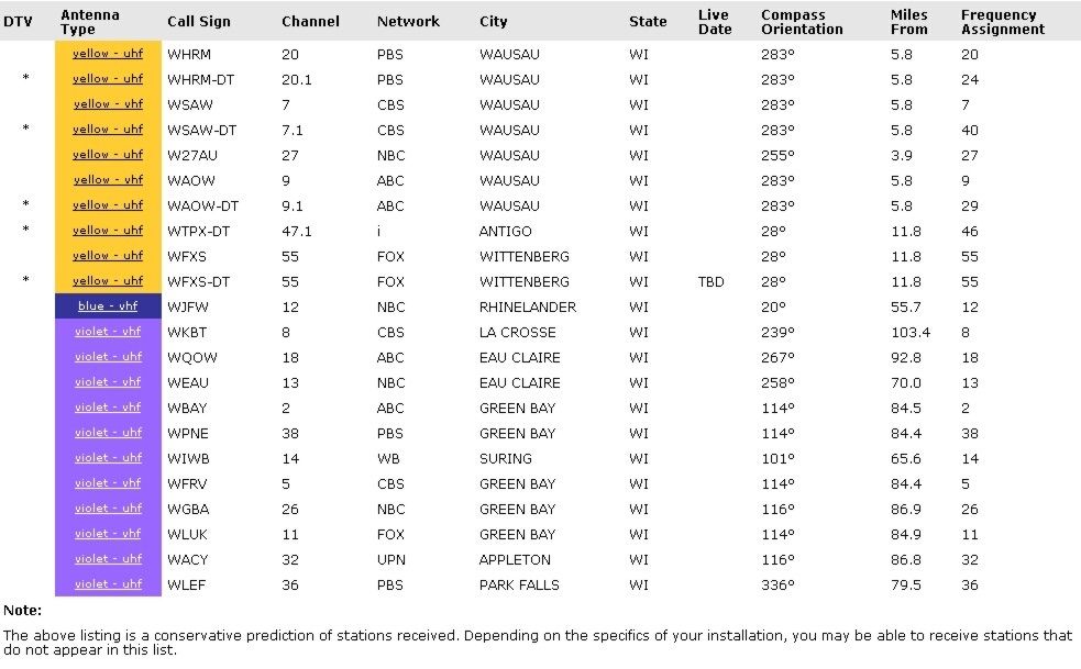

Well, it seems your nightmare will be because your affiliate uses a translator/repeater named W27AU to send you NBC WJFW and it is only 4 miles away. Your best bet is to call the station engineer first and ask them to assist you in receiving their digital signal and see what they say; then go forward after hearing what they have to say. If you do not like what they say or its determined that there is no way OTA is possible; then apply for your DNS.
Post back what your get worked out and how.
