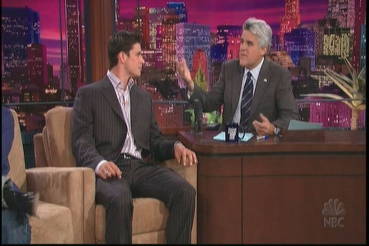

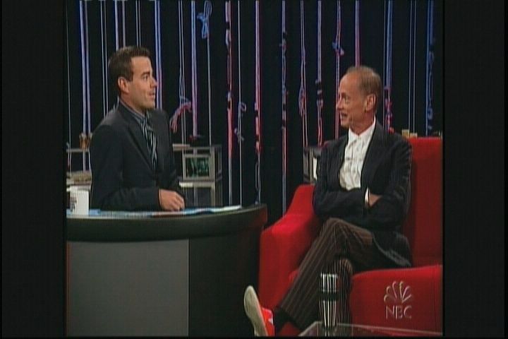

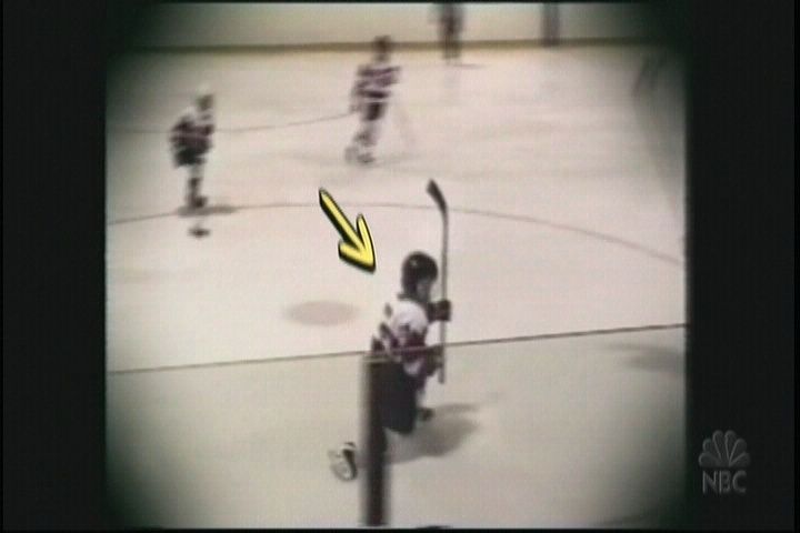

Hello sraider, I have voom receivers, on the remote control press voom -> green -> green select (1) picture format if you set the narrow to wide and wide to narrow correctly the video should look like attached photos at least for NBC. I done this with a widescreen computer i think the computer screens are 15:9 showing a slightly incorrect aspect ratio. I dont have an hdtv compatible or 16:9 tv hope this helps. :)
