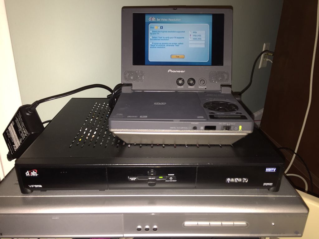

Wow, talk about good timing! My replacement 211k arrived this morning before I left for work, so it was able to sit inside and warm up. When I went to turn on the old ViP211, it was d-e-a-d. No Video, no response to the remote or front panel.
So I am in the process of activating the new 211k:
I like the smaller footprint, too!
