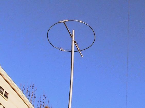

Roll your own friend... Build a VHF full wave loop. I am not sure if that is enough antenna though... Copper tubing say 3/8", Channel 2 would be about 5 1/2 feet diameter. I use one for VHF high all stations in my market are VHF high, about 30 miles away I get them all with the antenna mounted in my attic, and with no reflector element. A dipole or folded dipole would be about 8.2 feet long.
