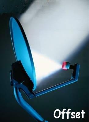

I am using a skew angle of 90 degrees as shown on the protractor at the back of the dish (straight up and down). I tried using the protactor on the side of the mast head but 33 degrees caused the dish to be pointed almost perpendicular to the ground. To get a true 33 degree angle from the horizon, I used my own protractor and a level and this produced a reading on the side of the mast head of about 57 degrees. To better illustrate, the dish is pointing about 5 minutes on a clock face skyward from the horizon line.

dont use the protractor because the dish is offset. It has a 22 degree "offset" so it may look like its facing the ground but it isnt. The signal comes down, bounces off the dish and hits the LNB "eye"
If the dish is suppose ot be at 33 degrees, then the elevation scale on the dish should be at 33. There might be a red line or just the edge to 33.

Don't let the offset dish angle confuse you... here's a pic showing how the offset works.
