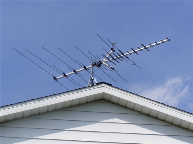

Winegard hd7082p or hd7084p antenna with winegard hdp 269 amp and cm 9521A rotor.... great suggestion dodge.
The amp is powered inside near the tv.
you do not have to mount high...enclosed is a pic of a hd7082p with a hdp269 mounted on a tripod... I cut off about 1.5' on a 5' mast to make it lower profile. I did not use a rotor here because all the towers were on the same hill....yours are in different directions and you will require one.
