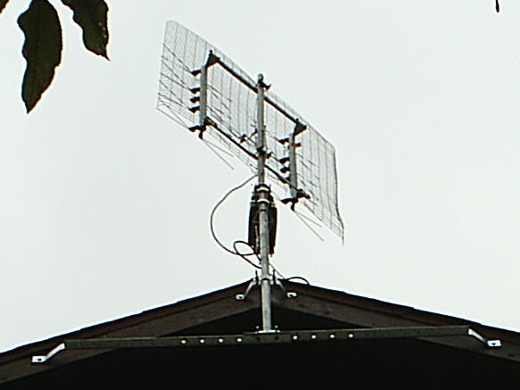

Just FYI,

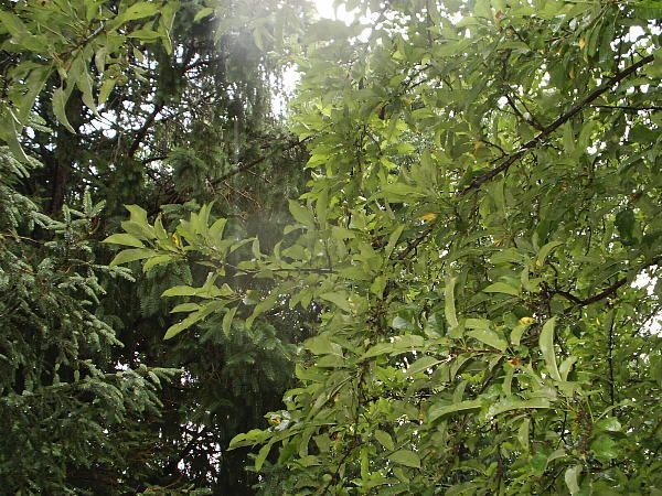

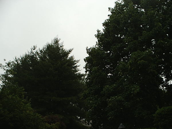

Attached is a picture of my antenna install, followed by a view of the trees towards Baltimore, and a view of the trees towards DC.
As you can see, there's lots of tall trees (ignore the closest tree in the DC picture -- its below the antenna).
-John
