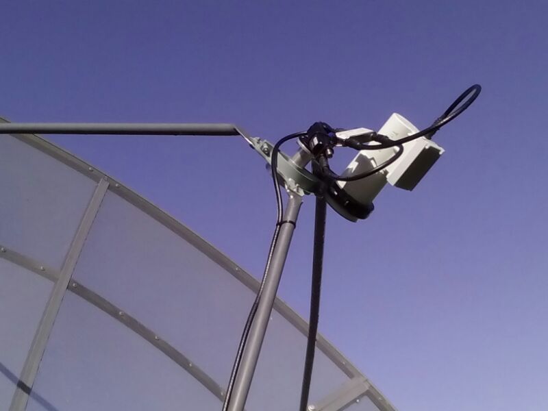

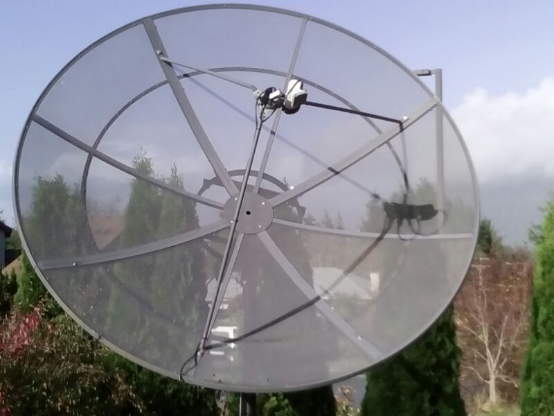

Taa Daa!
Today I took one of the supports off and added the prime focus Inverto Black Pro LNB and C120 feedhorn.
I made the Titanium C1WPLL the sidecar. It doesn't have a scalar but seems to be fine without it. Most signals are in the mid 70's
I lost a few Ku signals but most of what I want it coming in very well.
Thanks to everyone who helped me with this project. This would not have happened without all of you "satellite guys".
