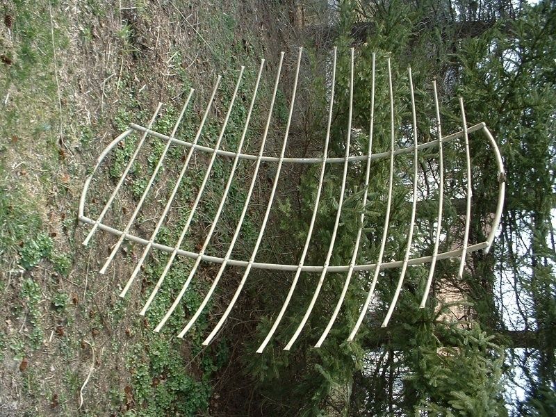

OK, So I took the time to dig out, and partially assemble my old UFH antenna. The way it stands now (if things work out the way I hope) I'll have a warped 7 foot BUD when I'm finished. Some of the elements are slightly out of true. I hope to make this better by finding the focal point and using a piece of string to bring the elements closer to where they belong. I also noticed that the LNB will be looking directly down the antenna arm. I don't know much about this, but I think that I might need a button hook design of some kind.
Tonight, in the name of Science, I plan to fabricate a complex Duct-Tape LNB bracket, and try to use an old circular LNB and my "Outdoor NASA alignment tool" (An old DTV receiver :) ) to try to see if I can get any signal strength on a DTV bird. This will be without any screen modification. I think that the reflector element spacing (as it stands now) wont work at all for this frequency, but I'm really interested in seeing what it might do. If this wont work, I'll dig out my nine dollar satellite pwr. meter and see what comes of that.
Anyone want to hazard a guess on my chances of making this work?
Any guesses on the amount of power I might find (not find) tonight?
At least I'll be ready for OTA DTV, Tron :)
Edit- Oops, I forgot to rotate my picture! :)

I just got back from working with the dish. So far I have nothing. I'm not really surprised....I will admit that I had hoped to get at least get a bar or two on the level indicator. I'm having the misfortune of misplacing my power meter. :(
Thanks for the excellent link Tek465m. I've only had time to skim chapter four. I think you're right about the focus. I've been moving it up and down, but it's hard when you don't even know if you're focused on a satellite. I guess that I'll have to invest the time in screening it somehow. Sure do wish that I could find that power meter!

Just writing to inform anyone who might be interested, that I'm shelving this particular project.
The antenna did show some promise, being able to get a small (very small) power reading without any modification. However it didn't show the initial results that I had hoped for. Second, it became obvious that the tilt needed would be a killer next winter. The amount of snow that it would hold would be a real problem. Something as flimsy as this would certainly need to be offset.
