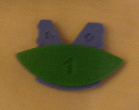

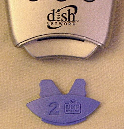

The TV2 remote is (by default) UHF but can be turned into an IR remote by flipping the little tab at the bottom (see attached pictures).
The kit that has been mentioned is simply a TV2 (UHF) remote that has a number "1" on the UHF side of its tab - versus the standard/included UHF remote that says "TV2" on the bottom.
So there really is no benefit in buying the kit. It will cost the same (if not more) as buying another TV2 UHF remote off of eBay and following my earlier instructions. And even if you could just get the TV1 tab real cheap, you would still need a UHF capable remote to put it in. Again, no benefit in that. As long as you don't mind your TV1 remote having "TV2" on it, what AJF is doing is the best way to go.

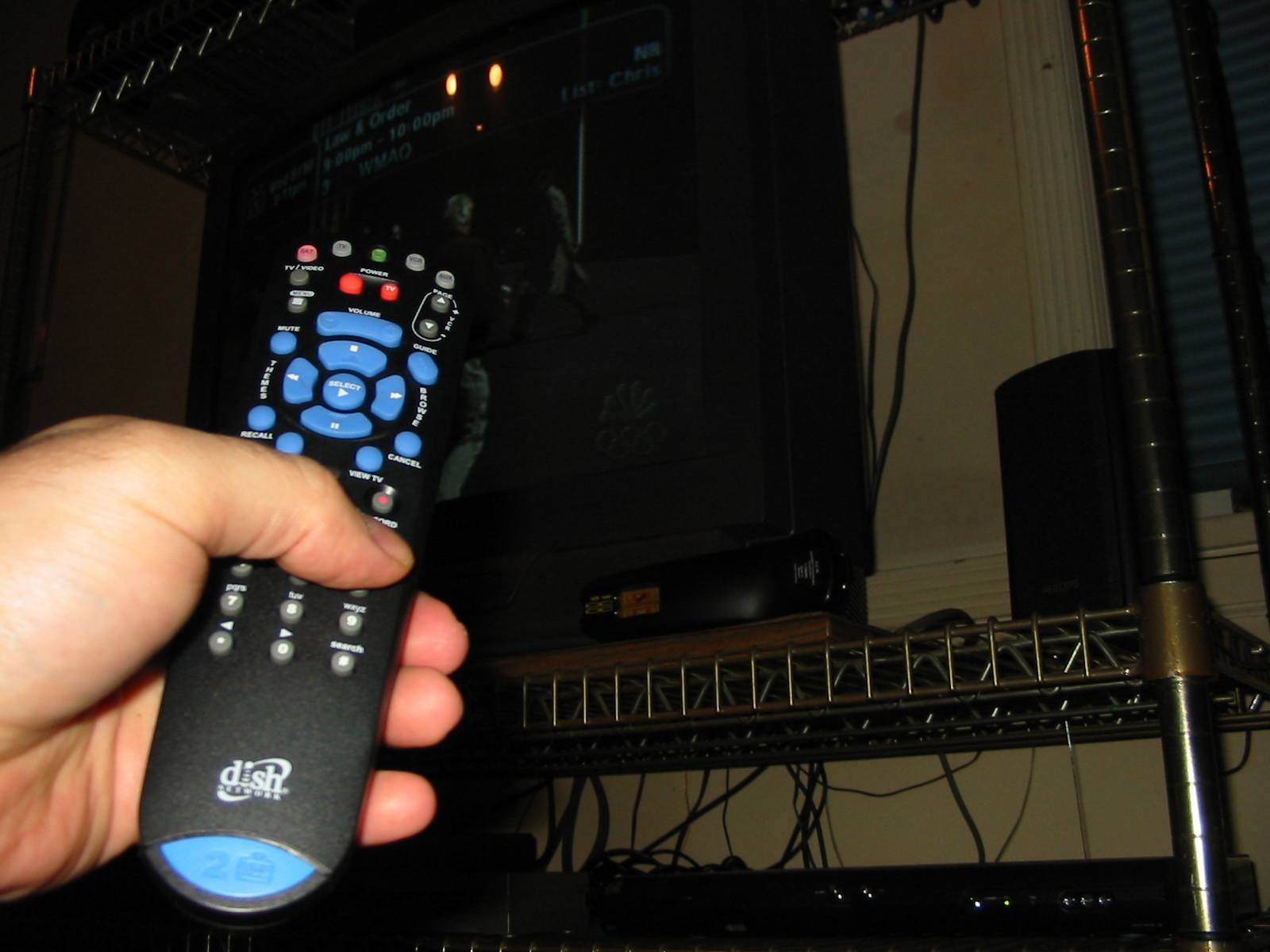

I hate to rain on your parade, but I'm controlling TV 1 of my 322 with a UHF remote as I type this. And believe it or not, it's the TV2 UHF remote that came with the 322. I'm sorry to tell you this, but you must not have been setting the address correctly. You can go back to page one of this thread and print my instructions. Take them with you on your next 322 job and try it again just for the hell of it. Follow my instructions exactly as they're written and it is guaranteed to work. ;)
Edit: Just so you know that I'm not blowing smoke, here's a picture I just snapped as proof. Note the TV1 remote in front of the TV with no batteries in it. Note the red sat button lit up on the TV2 (UHF) remote. Note the 322 box in the lower right corner with the blue TV 2 light off and the green TV 1 light on. Note the banner that shows the TV changing from channel 5 to channel 3. Note TV 1 on a 322 being controlled with a TV2 UHF remote. :)

Chris,
I stand corrected!!!
I hooked up a 322 in the office this morning and used a TV2 UHF remote to set it up - it worked using the exact procedure you outlined.
I know we tried all different remotes before, my only thought is the procedure in the book listed for the 522 upgrade kit is different than what your procedure is and that's why it wouldn't work. ????? I don't have the instructions with me now to compare.
Oh well, it's working now:rolleyes:
