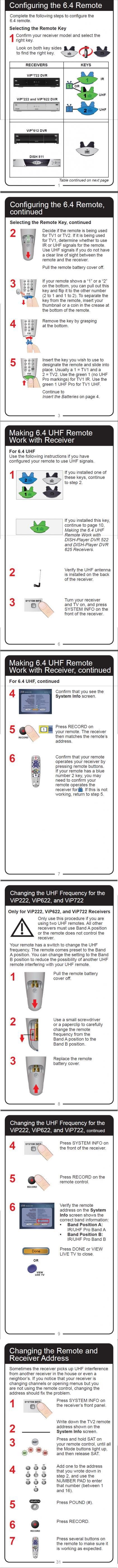

Here, this should help you out. Click the pic to enlarge :-

Thanks for the remote pics. Here's my Sys Info screen before and after pressing the Record button, nothing changed:
