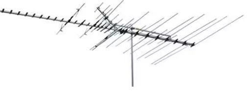

This is a Winegard 8200-U VHF-low, VHF-high and UHF antenna. The three longest elements on the right are for channels 2, 3 and 4. The channel 2 element (longest) is 110 inches or 2.79 meters tip to tip. The boom is 4.27 meters long, a VERY large antenna.
You are 8,714 kilometers from New York City. Typical low VHF reception becomes fringe at 120 KM

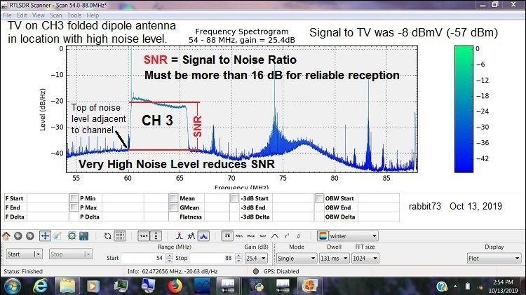

DXing digital ATSC 1.0 TV signals is more difficult than DXing analog NTSC signals. With weak analog signals, you are still able to see an image even if is very snowy.
But, with ATSC 1.0 digital signals, you will not see an image unless the tuner can lock on to the signal, which is only possible when the SNR of the signal is more than about 15.2 dB.
In order to know if the signal is there, even if the TV tuner can not lock on to it, you will need some kind of spectrum analyzer to show the hidden signal. An inexpensive SDR can be used as a spectrum analyzer to show a weak signal. Its pilot carrier will show above the signal, even if the rest of the signal is hidden in the noise.
I have a very high noise level on VHF channels 2-6, so a signal must be very strong to receive above my noise level.
