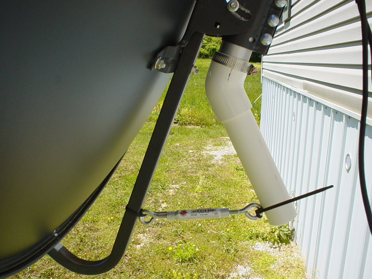

Check out this elevation adjustment tool. This is a turnbuckle. Turn it one way and it raises the dish. Turn the other way and it lowers the dish. For adjusting only, tighten the screws securely after adjustment. The 1 1/4 inch PVC pipe fitting fits over the end of the 42 mm motor tube. That is a 45 degree fitting, then a little length of pipe. I cut 4 hack saw cuts in the top socket end of the fitting, then tightened with the hose clamp. The two ends of the turnbuckle are held with cable ties. You can't see it but I drilled two holes in the pipe about the width of the turnbuckle eye where the turnbuckle attaches to the pipe. The cable tie passes through the two holes just on either side of the turnbuckle. I will probably take this off after I finish adjusting.
I don't think it was bending. I had the screws loose and the dish moved easily. Perhaps use a smaller turnbuckle higher up and there would be even less chance of bending. I have good signal now, so I don't think anything bent.
Lamp
Not to confuse anyone but you are actually adjusting "Declination" with that. Which is indeed hard to get perfect and your simple setup makes it way easier.
Fine tuning a dish can be a challenge more so when you have a motor on it. I think I will try this one and as "lamp" suggests placing the turnbuckle higher up on the arm.:)
It would be nice to add something to that where you can have a bar go through a hole in the middle to fine tune it for leverage and more fine tuning adjustment.

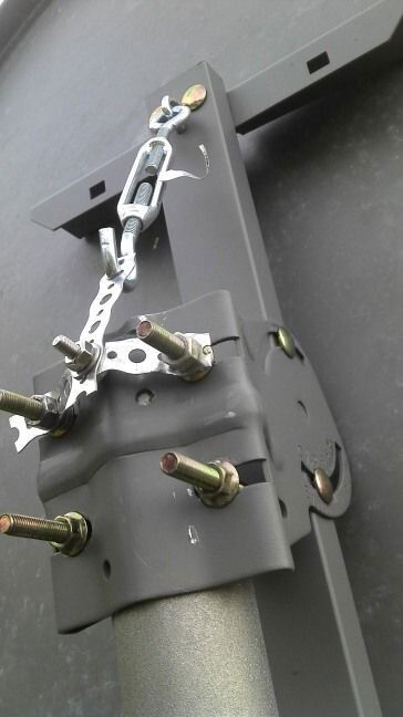

Very cool. The one I did for my Fortec 1.2m on a STAB HH120 has made an incredible improvement. Is there a place for dish mods on this site? It would be cool to have an easy to browse folder on Satelliteguys of various make/model dish mods.fortec 120cm fine tuning on the cheap and easy.jpg
