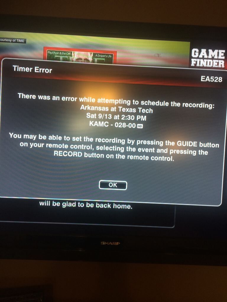

Something weird is going on. When I try to set timer to record a college football game on Saturday from 2:30 to 6:00 on abc a window pops up that says attention 531 please wait while we search for events that match your request. That win do stays up for a good few minutes then goes away and it doesn't set a timer to record that game. Everything else I try to record on that day on other channels and that channel at other times and it works fine but for some reason it will not record my game. Any ideas ?
Then just now I went into game finder and tried to record it that way and got this message
Yeah I don't see any way it could be blacked out. It's regional abc. But I guess stranger things have happened.

lol. Niiiice. Idea just occurred. What if you try to set a wierd manual timer. Not sure of the guide has it set 2:30 to 6(I think that's what you put) try doing a manual timer from like 2:15-7.
You magnificent genius it worked. I haven't had dish or the hopper for very long and didn't even know you could do that ( set a timer to just record a certain channel for a certain amount of time instead of setting timer to record a program ). Thanks for the help.
No problem. Same thing though. Let us know what happens when it does record. I'm curious just if it's blacked out(like you said, crazier things have happened)
Recorded the game just fine. Had to delete pretty quick though due to the outcome. Lol
