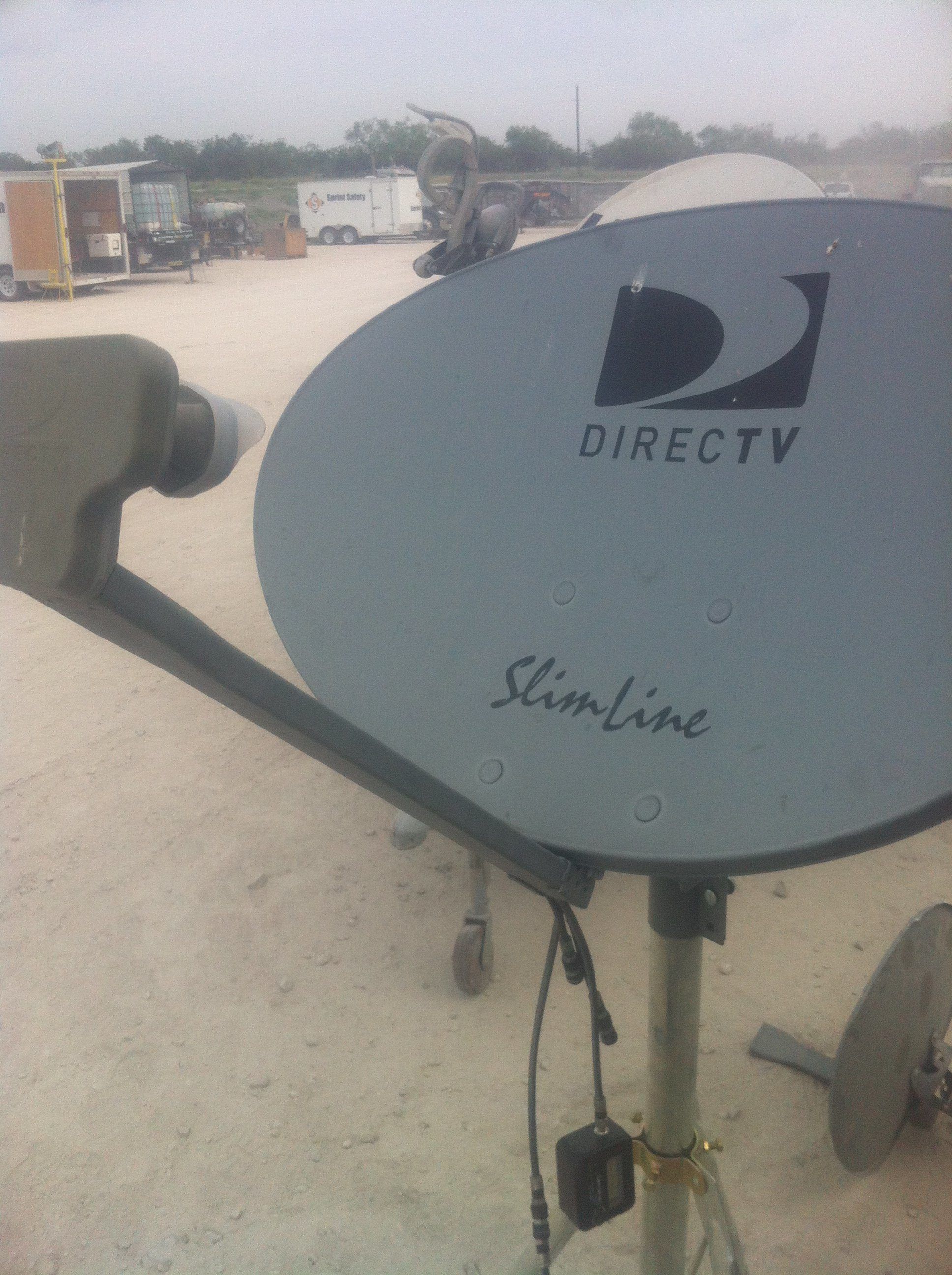

So to start we are trying to set up a Satellite for our Datavan down in South Texas. We are trying to piece this together so we are not even sure if the equipment we have is going to work. We have a DirecTV Slimline SL3 Pig-P MSat ka/ku LNB with a built in multiswitch. We are running it to a DirecTV HD receiver inside the van using a coaxial cable. The receiver box is saying it is not detecting the satellite at all. We have tested the cable line and it is still good. What am I missing?

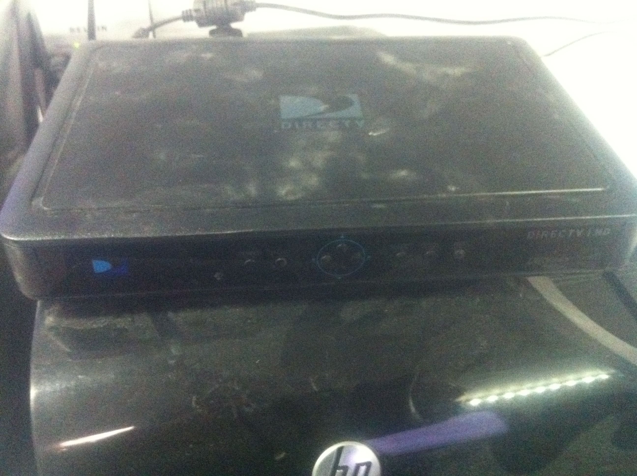

From the pics it appears to be a 4 wire lnb with an h25 receiver. That receiver does require swm and will need a swm lnb with a power inserter.
Yes it is a 4 wwire lnb and the receiver is h25-500. Stardust - Are you saying i need a different lnb to use the receiver or is there some way to get mine to work. Also what is a power inserter?

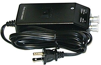

Yes you need a swm lnb to work with the h25 receiver. The power inserter looks like the attached picture & would go inside near the receiver. It is labeled accordingly.

The only way to make that 4 wire lnb work is with an H24 receiver and b band converter.

Not the only way. He could get a swm8 switch to connect the H25 to, since it's a swm switch.
First off thanks for all the help everyone. Raoul 5788/Stardust - Can yall explain to me the difference, I am not exactly full conversed in satellite speak. Also can you just buy an h24 receiver and use the direcTV card from the H25 receiver? Also is it even possible to just buy an h24 receiver? I am looking for the easiest way to get our Satellite up.
You can use an H24 and it will come with it's own card. You can't swap cards between boxes. A swm8 or swm16 is a switch that converts a normal signal into a swm type. It would allow you to use an H25 or HR34, both of which are swm only, with a normal non swm lnb.
